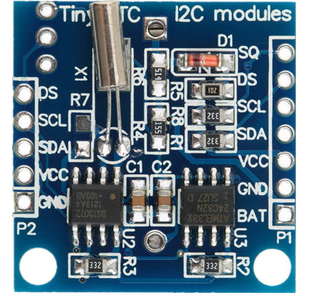

  • Connect RTC DS1307 module pin[VCC] to Arduino pin[5V]
  • Connect RTC DS1307 module pin[GND] to Arduino pin[GND]
  • Connect RTC DS1307 module pin[SDA] to Arduino pin[SDA]
  • Connect RTC DS1307 module pin[SCL] to Arduino pin[SCL]

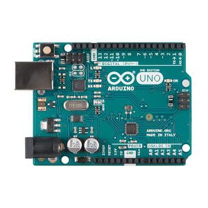

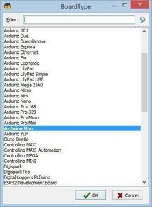

Step 3: Start Visuino, and Select the Arduino UNO Board Type
The Visuino: https://www.visuino.eu also needs to be installed. Download Free version or register for a Free Trial.

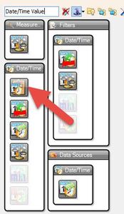

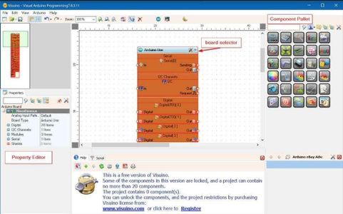

Start Visuino as shown in the first picture Click on the "Tools" button on the Arduino component (Picture 1) in Visuino When the dialog appears, select "Arduino UNO" as shown on Picture 2

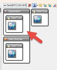

Step 4: In Visuino Add Components
  • Add "Clock Generator" component
  • Add "Date/Time Value" component
  • Add ""Real Time Clock(RTC) DS1307" component
  • Add "Decode(Split) Date/Time" component
  • Add 2X "Split Integer Digits" component
  • Add "Maxim LED Display Controller SPI MAX7219/MAX7221" component

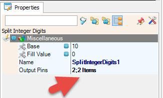

  • Select "SplitIntegerDigits1" and in the properties window set Output Pins to 2
  • Select "SplitIntegerDigits2" and in the properties window set Output Pins to 2

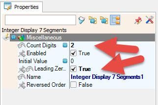

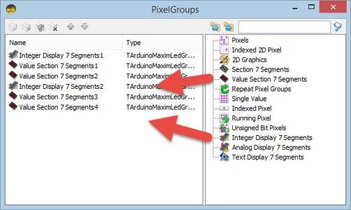

Double click on the "LedController1" and in the "PixelGroups" window drag:
  • "Integer Display 7 Segments" to the left side, and in the properties window set "Count Digits" to 2 and "Leading Zeroes" to True
  • "Value Section 7 Segments" to the left side, and in the properties window set "Initial Decmal Point Value" to True
Close the "PixelGroups" window

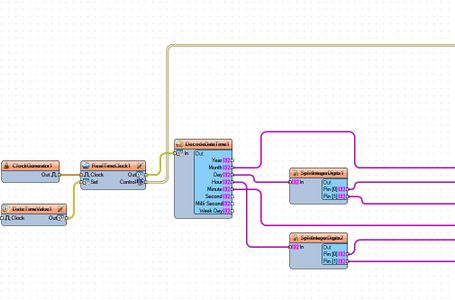

Step 6: In Visuino Connect Components
  • Connect "ClockGenerator1" pin Out to "RealTimeClock1" pin Clock
  • Connect "DateTimeValue1" pin Out to "RealTimeClock1" pin Set
  • Connect "RealTimeClock1" pin Out to "DecodeDateTime1" pin In
  • Connect "RealTimeClock1" pin Control I2C to "Arduino" pin I2C In
  • Connect "DecodeDateTime1" pin Month to LedController1 > Integer Display 7 Segments1 pin In
  • Connect "DecodeDateTime1" pin Day to "SplitIntegerDigits1" pin In
  • Connect "DecodeDateTime1" pin Hour to "SplitIntegerDigits2" pin In
  • Connect "SplitIntegerDigits1" pin 0 to LedController1 > Value Section 7 Segments1 pin In
  • Connect "SplitIntegerDigits1" pin 1 to LedController1 > Value Section 7 Segments2 pin In
  • Connect "SplitIntegerDigits2" pin 0 to LedController1 > Value Section 7 Segments3 pin In
    Connect "SplitIntegerDigits2" pin 1 to LedController1 > Value Section 7 Segments4 pin In

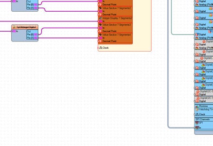

  • Connect "DecodeDateTime1" pin Minute to LedController1 > Integer Display 7 Segments2 pin In
  • Connect "LedController1" pin Out SPI to Arduino Pin SPI In
  • Connect "LedController1" pin Chip Select to Arduino Digital Pin [10]
