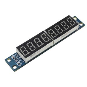

  • Max7219 Led Dot Matrix 8-digit Digital Display Control Module

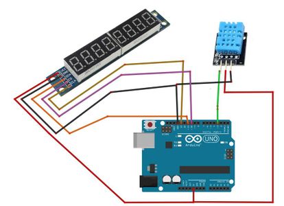

  • Connect DHT11 Sensor module pin[VCC] to Arduino pin[5V]
  • Connect DHT11 Sensor module pin[GND] to Arduino pin[GND]
  • Connect DHT11 Sensor Signal pin[S] to Arduino Digital pin[3]
  • Connect RTC DS1307 module pin[SCL] to Arduino pin[SCL]
  • Connect LED module pin[VCC] to Arduino pin[5V]
  • Connect LED module pin[GND] to Arduino pin[GND]
  • Connect LED module pin[DIN] to Arduino digital pin[11]
  • Connect LED module pin[CS] to Arduino digital pin[10]
  • Connect LED module pin[CLK] to Arduino digital pin[13]

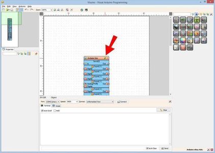

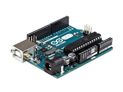

Step 3: Start Visuino, and Select the Arduino UNO Board Type
The Visuino: https://www.visuino.eu also needs to be installed. Download Free version or register for a Free Trial.
Start Visuino as shown in the first picture Click on the "Tools" button on the Arduino component (Picture 1) in Visuino When the dialog appears, select "Arduino UNO" as shown on Picture 2

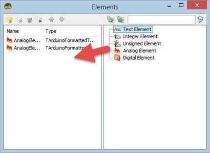

  • Doble click on the "FormattedText1" and in the "Elements window" drag 2X "Analog Element" to the left side
    and for each in the Properties window set the "Precision" to 0
  • Close the "Elements window"

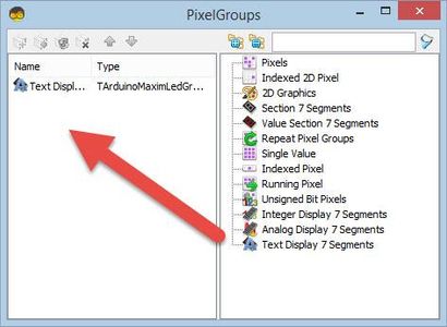

  • Doble click on the "LedController1" and in the "PixelGroups window" drag "Text Display 7 Segments" to the left side
  • Close the "PixelGroups window"

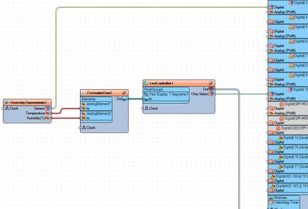

  • Connect "HumidityThermometer1" pin [Sensor] to Arduino Digital pin [3]
  • Connect "HumidityThermometer1" pin [Temperature] to "FormattedText1 > AnalogElement1" Pin [In]
  • Connect "HumidityThermometer1" pin [Humidity] to "FormattedText1 > AnalogElement2" Pin [In]
  • Connect "FormattedText1" pin [Out] "LedController1 > Text Display 7 Segments1" Pin [In]
  • Connect "LedController1" pin Out SPI to Arduino Pin SPI In
  • Connect "LedController1" pin Chip Select to Arduino Digital Pin [10]
