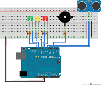

Step 2: Setup
- 5 volt pin on the Arduino -> bottom channel of the breadboard.
- Ground pin on the Arduino -> upper channel of the breadboard.
Buzzer -> pin 3
(On Ultrasonic Sensor)
Echo -> pin 6
Trig -> pin 7
(In Order from Right to Left)
LED1 -> pin 8
LED2 -> pin 9
LED3 -> pin 10
LED4 -> pin 11
LED5 -> pin 12
LED6 -> pin 13
Step 3: Breadboard
- connect the 5 volt and ground pin to the breadboard
reminder:
- the wire attached to the 5 volt pin -> the bottom channel of the breadboard
- the wire attached to the ground pin -> the upper channel of the breadboard
Step 4: Ultrasonic Sensor
- place the ultrasonic sensor as far right to the breadboard as possible
- ground pin on the ultrasonic sensor -> ground channel on the breadboard
- Echo pin on the sensor -> pin 6 on the Arduino
- Trig pin on the sensor -> pin 7 on the Arduino
- VCC pin on the sensor -> 5 volt channel on the breadboard
Step 5: LEDs
- longer leg (anode) -> a pin on the Arduino (with a jumper wire)
- shorter leg (cathode) -> the ground channel on the breadboard using a 330 ohm resistor
- repeat for all six of the LEDs
- last LED all the way on the left should have its anode -> pin 13 on the Arduino.
Step 6: Buzzer
- attach longer leg of the buzzer -> pin 3 of Arduino and
- attach shorter leg of buzzer -> ground channel of breadboard
