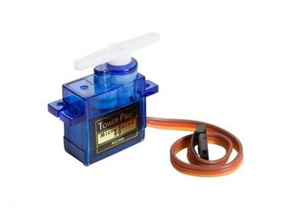

Secondly the servo-motor, which we placed in the neck area cut to give mobility to the head,
