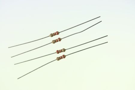

Step 4: Resistors
1. 10K Resistor
A. Place one end in H14 and the other in a "+"
2. 330 Resistor #1
A. Place one end in B3 and the other in any "-"
3. 330 Resistor #2
A. Place one end in B6 and the other in any "-"
4. 330 Resistor #3
A. Place one end in B9 and the other in any "-"
5. 330 Resistor #4
A. Place one end in B12 and the other in any "-"

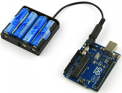

Step 8: Power
A portable source of power is used to ensure that the project will not require a constant computer connection to stay running. A battery holder is attached to the Redboard. Then, four AA batteries are inserted, giving a constant power of about 6V.
