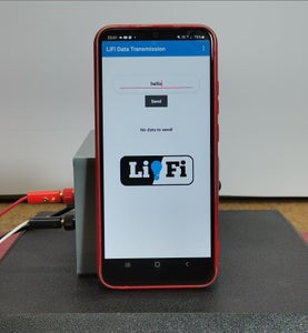

The mosfet transistor can be any one with medium or high power, and the relay is designed for 12V operation. As for the LDR module, it contains a LM393 comparator IC, and when the resistor is illuminated, the output voltage should be 0V, and +5V in the dark.
The key to unlock is actually the mobile phone on which the corresponding application is recorded.
First, let's explain how the device works. The smartphone application contains several predefined passwords, and to activate the flash we must enter one of these passwords, in my case it is "hello". Each password generates a flash activation with an exact preset time in milliseconds. On the other hand, the lock is activated only when we bring light to the LDR resistor with the exact time specified in the Arduino code, which should be identical to the time defined in the smartphone application. This time is very precisely defined, so theoretically it is almost impossible to unlock by manually turning the flashlight on and off.
Now let's see how the device works in real conditions:
When switched on, the red LED lights up, which means that the lock is in standby position and is waiting for an opening signal. First, let's try manually turning the flash on and off. As I mentioned before, it is impossible to open the lock this way. Now we will try with the Application. If we enter some random password, the flash is not activated at all. If we enter one of the previously defined passwords that is not common with the Arduino code, the flash is activated, but does not open the lock. Only if we enter the selected password, the door will open, in our case it is "hello". The green LED lights up and the relay is activated for 2 seconds, during which time we can open the door.
