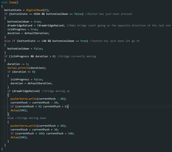

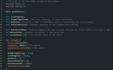

Step 3: Code (Servo Version)

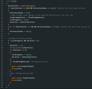

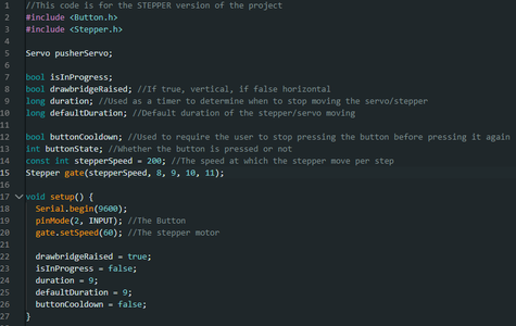

Step 4: Code (Stepper Version)
