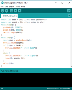

Step 4: Coding
Connect your Arduino to your computer and upload this code:
}const int dark = 200; //set dark parameters
const int sound = 50; //set noise to play
void setup() {
pinMode(2, OUTPUT);
pinMode(A2, INPUT);
Serial.begin(9600);
void loop() {
int light = analogRead(A2);
if (light < dark) {
Serial.print(light);
Serial.println(" It's dark");
else {
Serial.println(" It's light");
tone(2, sound, 10);
delay(10);
Open the Serial Monitor in the Arduino program, and watch what happens!
