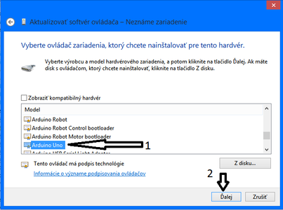

Hi. If you bough an new Arduino but you receive "Unknown USB device(Device Descriptor Request Failed)" then this tutorial is for you. And also sorry for slovak language in images.

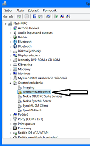

Step 2: Find Device
Find device that says "Unknown USB device(Device Descriptor Request Failed)" and go to next step. You can also receive Unknown device (Neznáme zariadenie). So next step ahead..

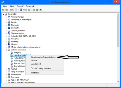

Step 3: Update It!
Right-click and update device's driver.

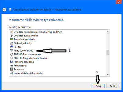

Step 6: Select Type
Select "COM Ports" or similar

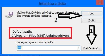

Step 7: From HDD
Hit from HDD and then choose path to folder. Default is "C:\Program Files (x86)\Arduino\drivers" on 64-bit.
On 32-bit choose "C:\Program Files\Arduino\drivers"
If you have Arduino Nano or similar with FTDI chip (NOT an ATMega), you need to try look in the folder \drivers\FTDI.

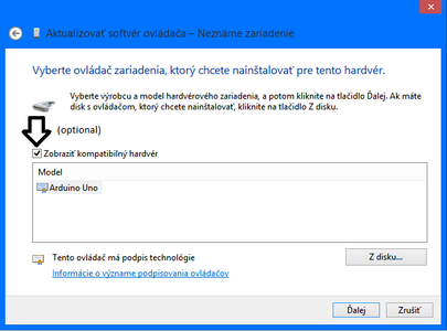

Step 8: Choose the Arduino
Now if you need it uncheck "Show only compatibile hardware" or similar or just choose your Arduino and click "Next".
Step 9: Finally...
Your Arduino should be successfully installed to your system. So Close it, Read your port aaaand... SUCCESS!
