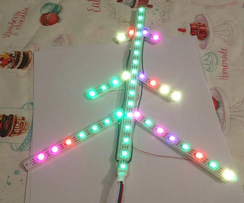

Step 1: Preparing the Base
First of all, you will need to cut the 1 meter RGB LED strip in half and wire the pins together (GND to GND, D to D, +5V to +5V). This will give you a 50 cm long double strip.
Now you can take some wood and cut it to size, it should be just slightly longer than the LED strip and just a bit more wide. You can use any other material, but I think wood looks better.
Secure only the ends of the RGB LED strip to the board with scotch tape or (hot) glue.

Step 3: Wiring It Up
Wiring up the module (NodeMCU) to the LED strip is easy, but you will need to do some soldering to separate out the wires from the LED strip. Also, make sure to add a 1000 uF 6.3V(or more) capacitor between the + and GND, close to the LED strip, this will help stabilize the power.
Wiring is:
  • Connect +5V (USB VCC) from NodeMCU to the LED strip +5V
  • Connect GND from NodeMCU to LED strip GND
  • Connect pin marked "D7" from NodeMCU to "D" on the LED strip
If you are using Arduino, you can connect any digital pin (D2-D13) to the LED strip, just make sure to match it in the source code.
