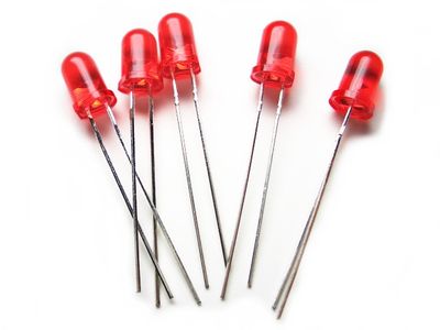

- 7 Led lights

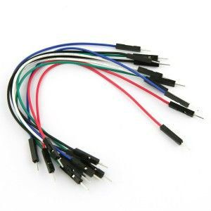

- 10 wires

Step 1: LEDs
- Get 7 led lights and construct them in an H pattern on the breadboard so their are 3 LEDs on each side and one in the middle.

Step 4: Wiring
- Add wires to to the positive end of each LED and connect it to a number slot on the arduino circuit board.
