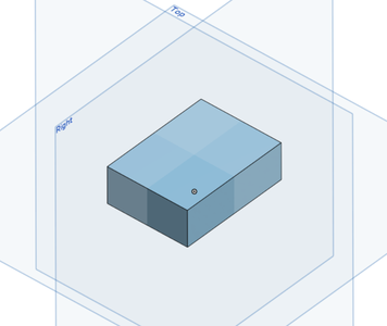

In terms of 3D modeling, I took the measurements from my notebook and made a little box that would act as my Arduino. For each of my models I would design around this box so I can keep a consistent size. This worked for the most part. The only thing I didn't consider and plan well for was tolerance and the size of the print.

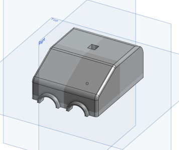

  1. Flower: The flower that took 6 hours to print even on low infill and it didn’t have enough tolerance for the Arduino. The idea was to have a top piece that clicks in but it didn't feel worth it.

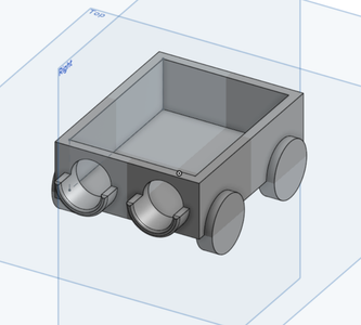

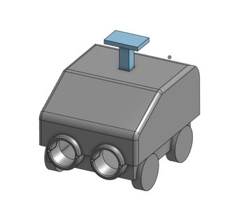

  2. Deer in the headlights: Thecar that would have the light come out of the headlights but that one ended up having too much tolerance! This was much smaller and took less time though.

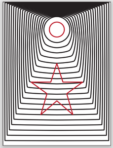

Thankfully I only had to make one iteration of this enclosure. I made this only using OnShape which was not as hard as I though it was going to be. At first I did mess up the spacing of the tabs that click together and then got some reference from MakerCase and figured out how I need to think about designing each piece. Also I used illustrator for the engraving on the top. For the button in this enclosure I used a small wooden dowel and added a circle of hot glue in order to make sure it hits the button on the Arduino every time. The box was wood glued in order to keep it together but the top was left unglued in order to put the Arduino in.
