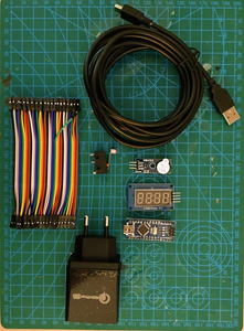

13$ for the whole materials:
  1. Female female jumper wires
  2. Arduino nano (all types should fit)
  3. Power/data cable
  4. Led dispkay module
  5. Microswitch
  6. Active buzzer
  7. Adapter (choose your type US / EU)
  8. solder+iron
  9. optional: quick connector
9. box - any box with a hinge will fit
