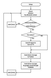

Step 4: Preparing Software of This Project (Flowchart)
  1. Setup : Initialize (Ethernet setting, Twitter account setting, TEMBOO & GOOGLE account setting, IRLED & Ultrasonic sensor pin setting)
  2. Check distance by ultrasonic sensor.
  3. Compare measured distance with initial distance.
  4. If measured distance is not initial distance we can assume that there is a trespasser.
  5. Turn on TV for alram and frighten tresspasser by IRLED
  6. Send twitter message to my account
  7. Send google email to me and/or my family.
Now... we prepared how can we write Arduino sketch by this flowchart now.
But we have 3 items to check first.
  1. How to control IRLED to turn on the TV
  2. How to send twitter message from Arduino
  3. How to send google email from Arduino through TEMBOO
