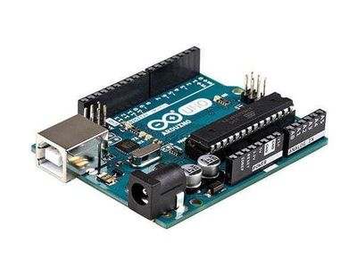

  • Arduino UNO (or any other Arduino)

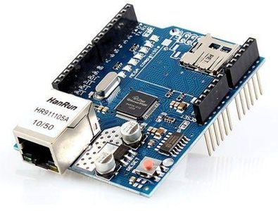

  • Ethernet Shield for Arduino

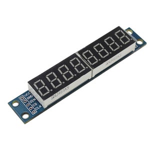

  • Max7219 Led Dot Matrix 8-digit Digital Display Control Module

  • Connect Internet LAN cable to the Arduino Ethernet Shield
  • Connect LED module pin[VCC] to Arduino Ethernet Shield pin[5V]
  • Connect LED module pin[GND] to Arduino Ethernet Shield pin[GND]
  • Connect LED module pin[DIN] to Arduino Ethernet Shield digital pin[11]
  • Connect LED module pin[CS] to Arduino Ethernet Shield digital pin[2]
  • Connect LED module pin[CLK] to Arduino Ethernet Shield digital pin[13]
Step 3: In Visuino Add Ethernet Shield

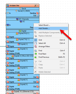

  • Right mouse click on the Arduino board and select "Add Shields"

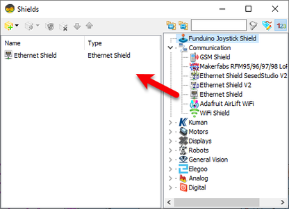

  • In the "Shields" window drag "Ethernet Shield" to the left side and in the properties window select "Sockets" and click on the 3 dots button.

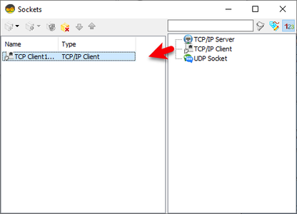

  • In the "Sockets" window drag "TCP/IP Client" to the left side and in the properties window set "Port" to 37 and "Host" to: time-c-g.nist.gov
  • Close the "Sockets" and "Shields" window

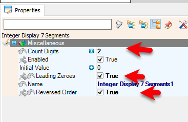

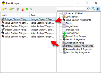

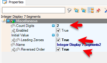

  • Double click on the "LedController1" and in the "PixelGroups window" drag "Integer Display 7 Segments" to the left side and in the properties window set "Count Digits" to 2, "Leading Zeroes" to True, "Reversed Order" to True

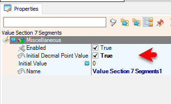

  • In the "PixelGroups window" drag "Value Section 7 Segments" to the left side and in the properties window set "Initial Decmal Point Value" to True
  • In the "PixelGroups window" drag another "Value Section 7 Segments" to the left side
  • In the "PixelGroups window" drag "Integer Display 7 Segments" to the left side and in the properties window set "Count Digits" to 2, "Leading Zeroes" to True, "Reversed Order" to True

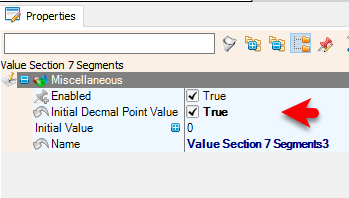

  • Close the "PixelGroups window"

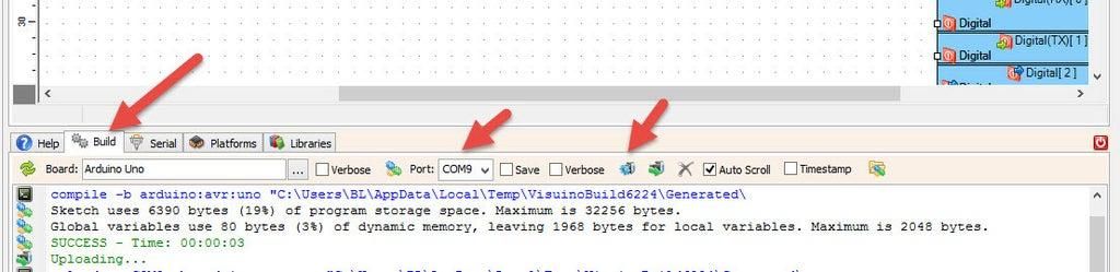

Step 7: Generate, Compile, and Upload the Code
In Visuino, at the bottom click on the "Build" Tab, make sure the correct port is selected, then click on the "Compile/Build and Upload" button.
