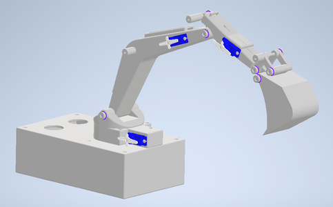

Introduction: Arduino Excavator
This instructable was created in fulfillment of the project requirement of the Makecourse at the University of South Florida (www.makecourse.com).
In this project we're going to build an mini excavator using parts printed on a Crealty Ender 3 and control it with an Arduino UNO microcontroller.

Step 1: Printing and Assembling
Using the STL files provided, print all the parts. This will take a long time, as most of these parts are more than 3hr prints. Best bet is to set it to print at night, check the first few layers go down well, then let it run through the night and into the next day if needed.
Once your parts are printed, you're going to assemble them with the servo motors, using the screws in the servo motor package to secure the servos, and the laptop screws to hold the excavator pieces together. You may have noticed the arms of the servo motors are not centered on the body of the servos, so pay attention to how the servos are installed in their spots in the excavator. The orientation of the servos is important because of the lengths of the control rods they actuate. If the motors are installed incorrectly, the excavator may not operate properly or in its full range. As you're looking at the faces of the pieces oriented as if the excavator were sitting on the ground as it will operate, the motor axes should be on the left. That is, they should be offset towards the back of the machine, away from the bucket. The base servo that pivots the assembly should have its rotation at the center of the circle on the bottom of the base, which would be offset towards the inside of the circle and not on the outside edge.
After securing the servos, you'll be ready to assemble the excavator pieces using the metric screws from the laptop kit, starting with the secondary boom (the one that attaches to the bucket). It's important to start at that end because of the wiring being routed through built-in recesses and how they join paths, and especially how the base unit wire routing works. If you assemble the base unit before doing the other pieces first, you're just going to have to take it apart again.
When putting the excavator pieces together, route the servo wires through the provided reliefs. The secondary boom will have its wire come up and out through the top, where it will be loose until entering the wireway along the top of the primary boom. The servo inside the primary boom (which moves the secondary boom) will have its wire join the other servo wiring in the top wireway.
At the split between the wireways (where the primary boom is bent) you will need to connect servo extension wires to the first servo's wires, since the servo wires aren't long enough to make it into the base unit. The extension wires have the same color coding as the servo wires, and the accompanying connection jacks, so just make sure the colors match from one side to the other, to avoid confusion. They should just click together. Then run the extension wires with the second servo's wires down the second wireway of the primary boom towards the base.
At the base of the primary boom, both sets of servo wires will need an extension jumper. Same deal - color to color, should click together. Then route the wires through the base unit that houses two servos.
Finally, the base unit gets assembled with all four servo wire groups going through the wireway exit in the bottom of the base unit, where they will connect with the Arduino via breadboard.
With all moving parts joined from their halves, you can install the axles that everything pivots on. The axles are sized exactly as wide as the joint they're intended for, so if it's off by a few millimeters, wrong axle. Use the metric screws to attach the caps to the axle rods (most likely M2x8).
The bucket can be done last - its linkage can be a little complicated if you're not already familiar with it. Doing it last will leave you fewer pieces to choose from for assembly. The linkage consists of four arms, one set attaching to the rear hole of the pair on the end of the secondary boom, the other set attaching to the higher holes on the bucket side. The arms on the bucket side go to the outside of the arms that attach to the boom side. The linkage requires three axles - two to attach the linkage to each part, and one in the middle to attach the linkages to each other, forming a moving triangle. That middle axle is the control axle, which has a long cylinder on one side. This control cylinder needs to be on the same side as the servo, as there will be a control arm from the servo to this axle. Notice the face of the servo and the face of the control axle are flush. If they are drastically different (more than 4mm variance) you have the wrong control axle in the linkage. The bucket pivots with a long axle that spans the entire bucket width, in the front hole of the secondary boom.
