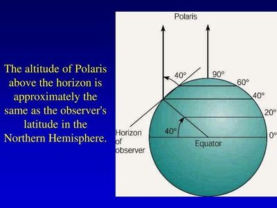

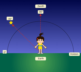

So the indication will show you both your latitude and the angle at which the North Star is in relation to the horizon in the north direction.
The angle of the Polaris star and the latitude are equal, as you can see in the attached images.
Lift the instrument and look in such a way that the horizon line is in the same line as the servo motor line. Try to keep both LEDs lit continuously. On a clear night you will see the North Star at the top of the indicator!
