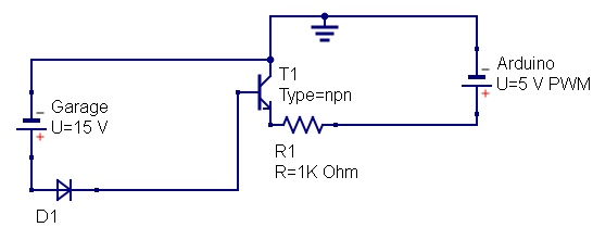

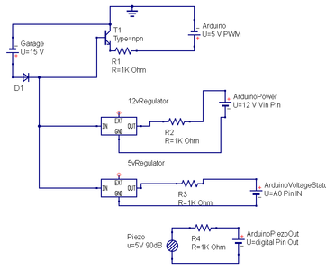

Step 1: How It Works
so how the entire project works.
1. The wires from the garage button mounted on the wall should be 15V, if not message me and ill help you(may need to change wiring and the program a bit). these wires should remain in the terminals of the garage door.
2. The diodes keep the high voltage from damaging the arduino board
3. When the fingerprint scanner detects a match it turns the red LED green and the applies 5V to the left prong of the transistor which switches and applies 0v to the positive terminal on the garage door(bridges the connections) for one second and then transistor "turns back off"
WIRES FROM GARAGE DOOR BUTTON ARE NOT REMOVED, THEY SHOULD EITHER BE SPLICED OR YOU CAN PUT THE REQUIRED CONNECTIONS IN THE TEMINALS WITH THE OPENER WIRES
WARNING!!!!
DONT FORGET THE DIODES!! THEY WILL PREVENT THE 15V-22V FROM BEING FED INTO THE TRANSISTOR AND THE BOARD!!

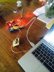

Step 3: Fingerprint Sensor
before using sensor(assuming you just bought it) you may have to "bypass" the atmega chip(blank sketch). heres a link on how, also you will need software.(SFG)
software
http://www.adafruit.com/datasheets/SFGDemoV2.0.rar
Bypass
https://learn.adafruit.com/adafruit-optical-finger...
I forgot to add the sensor in the diagram but..
Black wire - Ground
Red Wire - 3.2V or 5V( I am using 3.2V to keep the sensor from burning up, use resistor if you use 5V)
White or Yellow Wire - Pin3
Green Wire - Pin2
ENROLLING WITH SGF
White or Yellow Wire - Pin0
Green Wire - Pin1

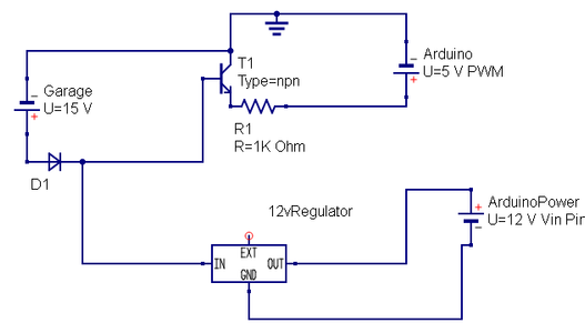

EXTRA
POWER:
instead of using the usb or the external jack lets just use what we already have.
1. The positive and Negative leads for the garage door opener are spliced and connected to a 12V Voltage regulator.(negative also goes to GND on arduino board....i think, check voltage of 15V GND from garage door opener and 12V + from Regulator and make sure its 12V not 15V)
2. The Regulator applies 12V to the Vin port of the arduino to power the board
SWITCHES
the switches are used to switch between usb and onboard power for programing
and since you need to use pins 0 and 1 to enroll new fingerprints I added two mores switches to switch from pin 2 to pin 1 and switch from pin 3 to pin 0.
WARNING!!!!!
TURN OFF THE "ONBOARD POWER" BEFORE CONNECTING THE USB
SECURITY ALARM
for someone renting a house like me you might not be able to hide the wires going from the arduino to the garage door, meaning that anyone can cut those wires and touch them together to open and close your garage.
in this case an alarm would be needed.
my idea is to hookup a 90db piezo pulsing buzzer to arduino with a 5v voltage regulator in series with the transistor outputs.
the arduino would be measuring the 5v from the regulator and whenever that goes below 5v(someone cut the wires to the garage door) it will sound the alarm.

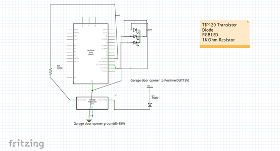

Step 7: Problems and Possible Solutions
1. ORIGINAL GARAGE OPENER( ON WALL ) DOES NOT WORK
CAUSES:
1. DIODE IS BACKWARDS
2. TRANSISTOR IS WIRED INCORRECTLY(SEE UPDATED PICTURE SCHEMATIC)
3. POSITIVE AND NEGATIVE WIRES ARE SWITCHED
2. FINGERPRINT SENSOR DOES NOT ACTIVATE OPENER
CAUSES:
2. CHECK TRANSISTOR WIRING
HOW TO TEST TRANSISTOR WIRING
1. USE ANY DC POWER SOURCE( PREFERABLY 12V )
2. USE A VOLTAGE METER TO CHECK VOLTAGE( SHOULD BE THE SAME AS POWER SOURCE V )
3. CONTINUE USING VOLTMETER....PUT YOUR FINGER ON THE SCANNER AND WAIT FOR THE LED( IF YOU INSTALLED ONE) TO CHANGE TO GREEN.
4. WHEN THE LED CHANGES COLOR(FINGERPRINT IS FOUND) THE VOLTAGE METER SHOULD DROP TO 0V FOR ONE SECOND AND THEN GO BACK TO 12V.

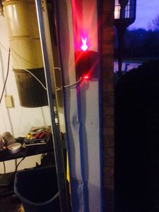

Step 8:
after your done put it inside a weatherproof box, you can find them on adafruit.com
comment or message if you have any questions, I will add more pics of my actual project and what it looks like when im done with it soon

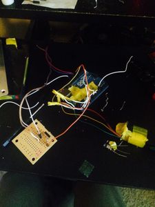

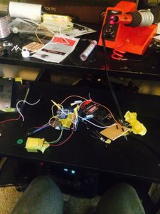

Step 9: My Project

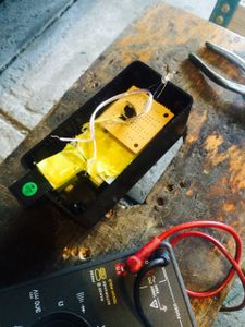

Step 10: The Current Board Im Using
this is a working board that I made. this board is currently being used in my project.
TRANSISTOR
1. left leg = to 1k ohm resistor + resistor to pwm pin
2. middle leg = to diode(black bar facing transistor) + diode to positive garage terminal
3. right leg = to negative pin and negative garage teminal
Step 11: ALARM(NOT YET TESTED)
whenever the voltage drops below 4v or "618"(if someone cuts the wires going to garage opener) it will sound the piezo buzzer
