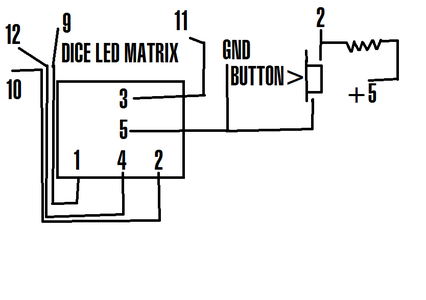

Step 1: Setting Up the Breadboard
The breadboard will consist of this circuit. The prototype's schematic is on the Newton Labs Website. The reason why we need a resistor is so that if any electrons get stuck after the switch is read then they will go through the resistor instead of waiting for the micro controller to take in more power.
