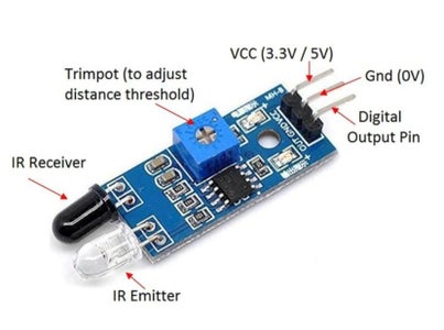

A flame detector is an electronic device designed to sense the presence of flames or fire. There are several types of flame detectors including ultraviolet, infrared, multispectrum detectors, and optical flame detectors. In the device described in this project, we will use an infrared type of flame detector which is widespread, inexpensive, and has satisfactory characteristics.
As the name itself tells us, this detector module consists of an Infrared receiving LED which is connected to an operational amplifier which processes the detected signal. Infrared LED has the ability to detect a light source in the infrared part of the spectrum. In the case of a flame, most of the spectrum that is emitted is in that infrared region.

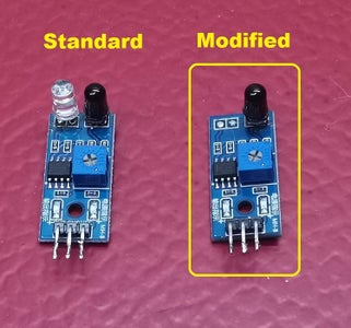

Let's first analyze the hardware part. For the Flame detector I use a standard IR sensor module with transmitter and receiver LEDs, where we need to unsolder and remove the transparent transmitter LED.

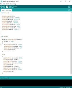

As for the Arduino code, it can be seen that it is extremely simple and therefore reliable, which should be a basic feature for this type of device.
At the beginning, variables are defined and created, and then in void setup, the inputs and outputs are defined, as well as their starting values. Then in the loop function we use an if-else statement that allows you to make decisions depending on the value of a variable.
