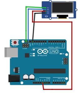

Step 2: The Circuit
  • Connect OLED pin [VCC]to arduino pin [5V]
  • Connect OLED pin [GND]to arduino pin [GND]
  • Connect OLED pin [SCL]to arduino pin [SCL]
  • Connect OLED pin [SDA]to arduino pin [SDA]

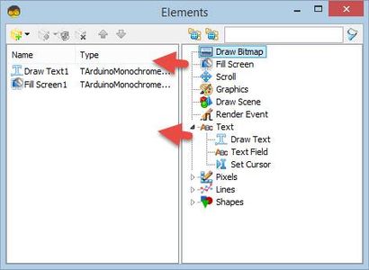

  • Double click on the "DisplayOLED1" and in the "Elements" window
  • drag "Draw Text" to the left side and in the "Properties" window set "Size" to 3 and "Text" to Flash <<You can adjust size,text and position if you want
  • Also drag "Fill Screen" to the left side
  • Close the "Elements" window

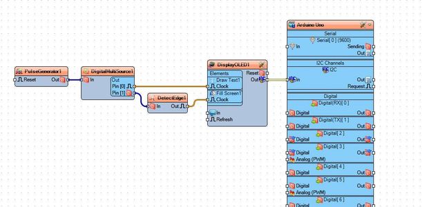

Step 5: In Visuino Connect Components
  • Connect "PulseGenerator1" pin [Out] to "DigitalMultiSource1" pin [In]
  • Connect "DigitalMultiSource1" pin [0] to "DisplayOLED1" > "Draw Text1" pin [clock]
  • Connect "DigitalMultiSource1" pin [1] to "DetectEdge1" pin [In]
  • Connect "DetectEdge1" pin [Out] to "DisplayOLED1" > "Fill Screen1" pin [clock]
  • Connect "DisplayOLED1" Pin I2C [Out] to Arduino Pin I2C [In]
