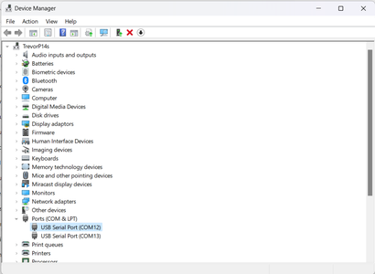

Note that the Maixduino board actually consists of 2 microcontroller chips
  • Kendryte K210: the main microcontroller that you upload sketch to
  • ESP32: basically a WIFI module for Maixduino
Therefore, when you plug your Maixduino board to your computer, you will see two COM ports for the Maixduino board -- the first one is for K210, the second one is for ESP32
Since it is not reasonable to expect PlatformIO to be able to detect which COM port to upload your sketch to, you specify the COM port with monitor_port and upload_port in platformio.ini
Please find out the COM port to use in your environment with the Device Manager. Note that the COM port likely will stay the same if you plugin your Maixduino board to the same USB plug.
