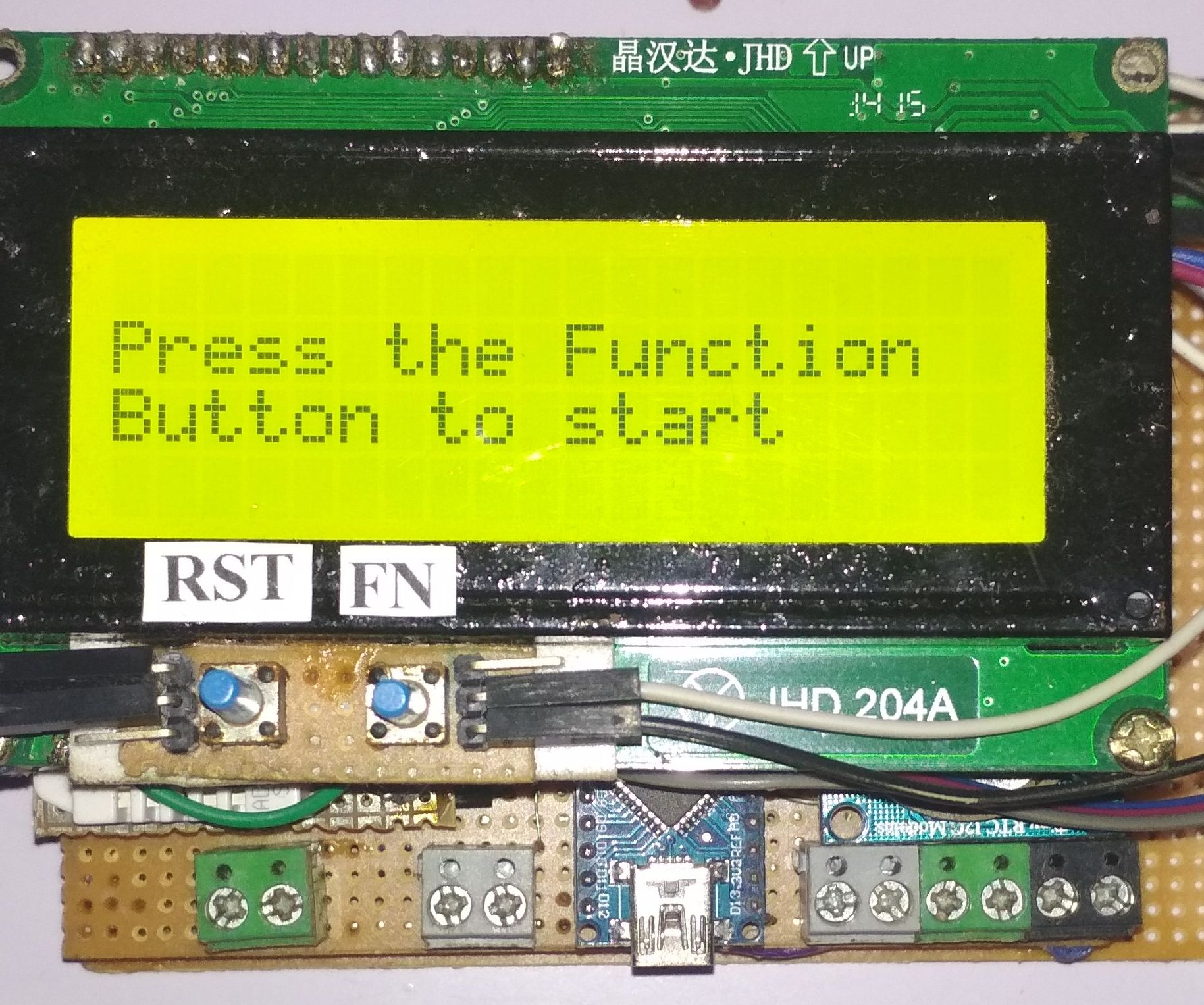

Introduction: Arduino Frequency Counter
About: iam a B.E Electronics and Communication Engineer. I have great interest on electronics.
To find out the frequency of any signal we need to use CRO. We can also use frequency meter.But both of them are costly.Using Arduino Frequency Counter we can easily measure the frequency of various signals.This Circuit can be easily made with very less cost when compare to CRO and Frequency Meter.
