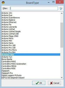

Start Visuino as shown in the first picture Click on the "Tools" button on the Arduino component (Picture 1) in Visuino When the dialog appears, select "Arduino UNO" as shown on Picture 2

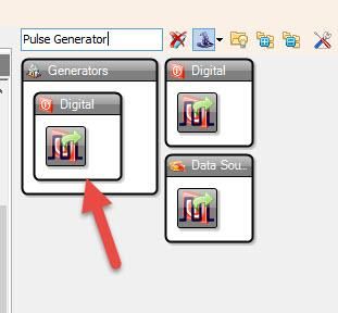

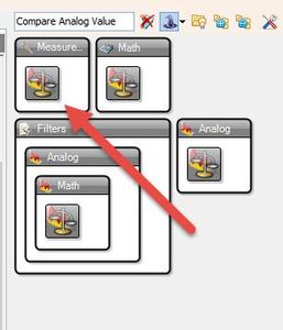

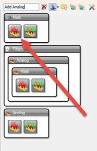

Step 3: In Visuino Add Components
  1. Add "Clock Generator" component
  2. Add "Counter" component
  3. Add "Analog Value" component
  4. Add "Integer To Analog" component
  5. Add "Add Analog" component
  6. Add "Analog Multi Source" component
  7. Add "Compare Analog Value" component
  8. Add "Analog On/Off Switch" component
  9. Add "Pulse Generator" component

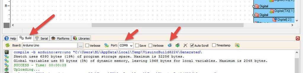

Step 6: Generate, Compile, and Upload the Code
In Visuino, at the bottom click on the "Build" Tab, make sure the correct port is selected, then click on the "Compile/Build and Upload" button.
