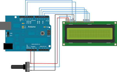

Step 2: LCD
Solder connector pins to the LCD and the same type connectors on the Arduino, so that you can easily plug them together. If you noticed that I had to change from the connectors in the previous step to this step a silly mistake that I made. You don't have to connect all of the 16 pins just the ones in the circuit will do.
Step 3: Circuit
Once you have done soldered the pins follow the circuit and connect the LCD to your Arduino. If you used a UNO I recommend soldering it on a prototype shield. I had the rheostat substituted with a resistance, the rheostat is used to adjust the contrast. You can find the proper level, in the following steps.
1)Complete the circuit connections
2)Upload "Hello World" code as in the IDE examples
3)Power the circuit and adjust the rheostat till you get a proper contrast.
4)Once you have the proper level, remove the rheostat and measure the value of resistance with respect to ground and LCD pin 3.
5)Replace the rheostat with the measured value of resistance.
