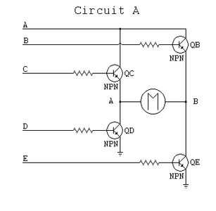

Step 1: Full Bridge Circuit A
With circuit A there are 4 transistor inputs and it works the same as all other full bridge circuits.
You can attach a PWM, (Pulse Width Modulator) to line A, too turn the motor on and off or control motor speed. You can also connect source voltage to line A and the PMW to the transistor inputs to reverse the motor and control the motor speed.
Close transistor QC and QE and the current flows from terminal A to terminal B through the motor, making the motor turn in one direction.
Close transistor QB and QD and the current flows from terminal B to terminal A through the motor, making the motor turn in the other direction.

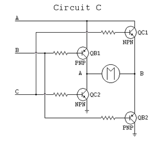

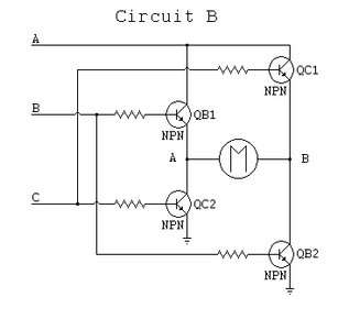

Step 3: Full Bridge Circuit B
Unlike circuit A this full bridge circuit only has 2 transistor inputs and although the circuit looks different they work basically the same.
Close transistor QB1 and QB2, and the current flows from terminal A to terminal B through the motor, making the motor turn in one direction.
Close transistor QC1 and QC2, and the current flows from terminal B to terminal A through the motor, making the motor turn in the other direction.

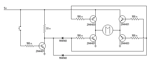

Step 4: The Logic Circuit
This is the logic circuit and the brain of my reversible motor drive, a single transistor inverter gate with the same logic input and output as a hex inverters gate.
The bridge circuit to use with the single transistor inverter is one consisting of NPN and PNP transistors.
When the output of the inverter gate is connected to the transistor inputs, and the logic input to the inverter is 0 and the output is 1 the NPN transistors are closed and the PNP transistors are open making the current flow from terminal B to A making the motor run in one direction.
When the logic input to the inverter is 1 and the output is 0 the PNP transistors are closed and the NPN transistors are open making the current flow from terminal A to B and the motor run in the opposite direction.
For circuit protection I used high speed diodes on the transistor inputs.

Step 6: Circuit Testing
Amazingly this circuit does what the Arduino circuits in this Instructable do using only one transistor.
I always build test circuits on a solderless bread board, if you use a prototype board and solder the joints any changes you need to make can be a pain.
I used a push button switch to simulate data inputs and ran the motor at full power, you can see the motor twist as it goes from forward to reverse and back in the video.
As is this circuit would make a good bump bot drive.
