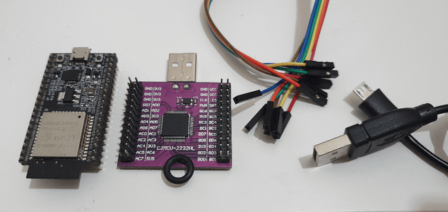

Ensure you have all the hardware below and Visual Micro installed on your PC, along with the sketch you want to debug.
ESP32 based board + USB cable
Hardware Debugger + USB Cable
7 x Jumper wires

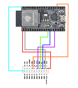

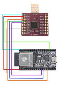

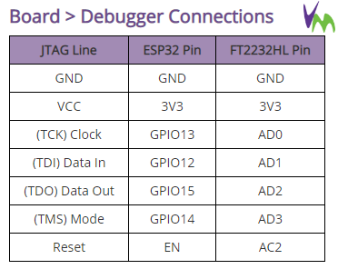

First we need to get the board and debugger wired together correctly, and it depends which ESP32 board you have and which debugger you are using, as to exactly how these wire together.
These connect using the standard JTAG interface and the generic wiring table is above, as the pin layouts often differ between the boards, and the debuggers in some cases.
In our case we are using the FT2232H Dual RS232 Adapter, which can be purchased at a very competitive price, and can be seen in the last image above wired to our ESP32 Board.

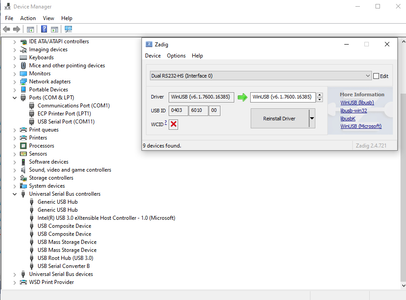

Step 3: Setting Up Additional Drivers
Some boards need additional drivers installing to allow the debugger to work correctly.
If you aren't sure then check the Debugger Support Listing on the Visual Micro Website for your Debugger / Board combination.
How to install these can be seen in the video in the next step, as well as below:
1. Install Zadig from "https://zadig.akeo.ie/"
2. Ensure Debugger is connected via USB port
3. Run Zadig as an Administrator
4. Select Options > List all devices
5. Drop down the list until you see your debugger device (in our case "Dual RS232 HS (Interface 0)")
Note - Ensure you select Interface 0 of your debugger

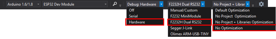

First ensure you have the project loaded you want to debug, and correct Target and COM port.
Change the option on the Debugger Menu to be "Hardware"
Then select the correct debugger from the list.
Finally change the Optimisation setting to the recommended "No Optimization"

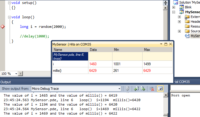

Now all we need to do is decide where we want to stop in the code to inspect what is happening.
Simply click in the left hand margin of your code, and you will see break point (red circle) appear.
Breakpoints can be adjusted once the code has been uploaded to the board if needed, but there are often a few places of interest.
Now you can Build & Upload, and start debugging by simply pressing Build > Start Debugger
The debugger will stop on the first break point, and allow you to inspect variables and step through the code to let you see what is happening line by line.
