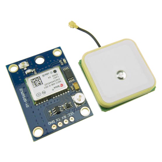

- NEO-6M GPS Module
GPS stands for global positioning system and can be used to determine position, time and speed if you are travelling.
- This module has an external antenna and built-in EEPROM.
- Interface: RS232 TTL
- Power supply: 3V to 5V
- Default baudrate: 9600 bps
- Works with standard NMEA sentences
The NEO-6M GPS module has four pins: VCC, RX, TX, and GND. The module communicates with the Arduino via serial communication using the TX and RX pins, so the wiring couldn’t be simpler:
NEO-6M GPS ModuleWiring to Arduino UNO
VCC VIN
RX TX pin defined in the software serial
TX RX pin defined in the software serial
GND GND

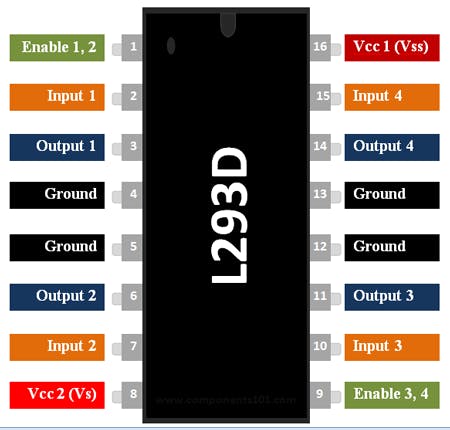

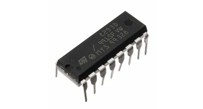

L293D IC
The L293D is a 16-pin motor driver IC which can control upto two DC motors simultaneously in any direction.
Why to use L293D?
The input to the motor driver IC or motor driver is a low current signal.The function of the circuit is to convert the low current signal to a high current signal.This high current signal is then given to the motor.

Connection to the L293D IC
- Connect 5V to Enable 1, Vs and Vss on the L293D
- Connect digital output pins (we are using 6 and 7 ) to input 1 and input 2 on the L293D.
- Connect your Arduino's GND to both GND pins on the same side of the L293D
- Finally connect output 1 and output 2 of the L293D to your motor pins.
