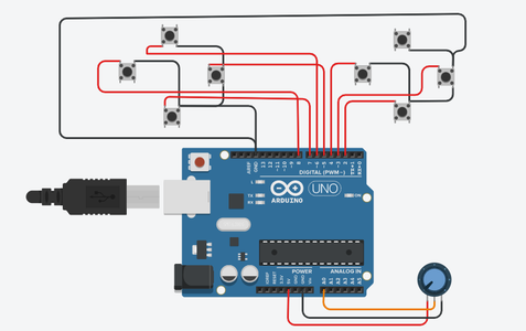

Step 2: Circuit Connection
In This project I used old Drone Transmitter . In the transmitter I used six Push Button and One Analog Joystick 1) Soldered All Six Push Button one pin as common for Ground
2) And Took Six Separate Wire from Push button For using as Input on Arduino Uno Digital Pins ( Use Digital Pins 2 - 13 )
3) In Analog Joystick I used X axis Only because In UnoJoy You Can use only one axis
4) Connect Analog Joystick Power and Ground Pin To arduino 5V and Gnd Pin
