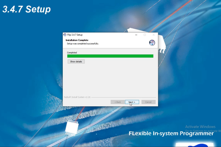

1) I have attached a UnoJoy File . In the file First Install JRE Flip Installer

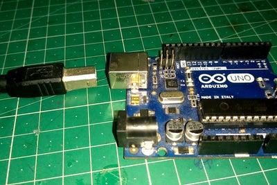

2) Then Connect Arduino to Your PC or Laptop

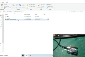

3) Open UnoJoyArduinoSample Upload the code to your arduino

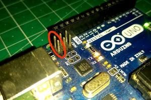

4) Short Reset and Ground Pin of Arduino Uno. To enter into DFU (device frimware update ) mode

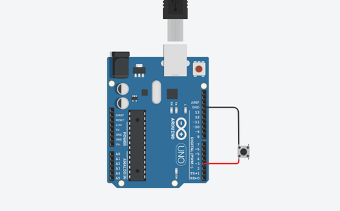

Circuit Diagram is very simple
Connect a push button Between Pin 3 and Ground
