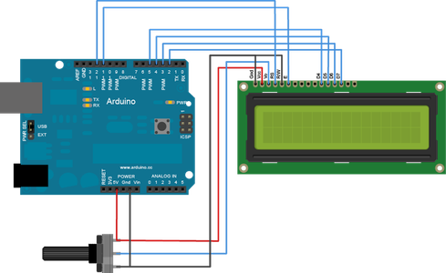

Step 1: Putting the Circuit Together
Materials:
Arduino Uno
16x2 lcd screen
2 potentiometers
breadboard
solder-less breadboard
1. Connect the potentiometer to the lcd screen, and the screen to the arduino as shown in the schematic below.
Arduino Uno
16x2 lcd screen
2 potentiometers
breadboard
Step 2: Finishing the Curcuit
1. Add in the second potentiometer to pin 1.
2. Attach the positive and negative wires to the correct pins on the arduino like shown below.
3. Mount everything on the breadboard.
