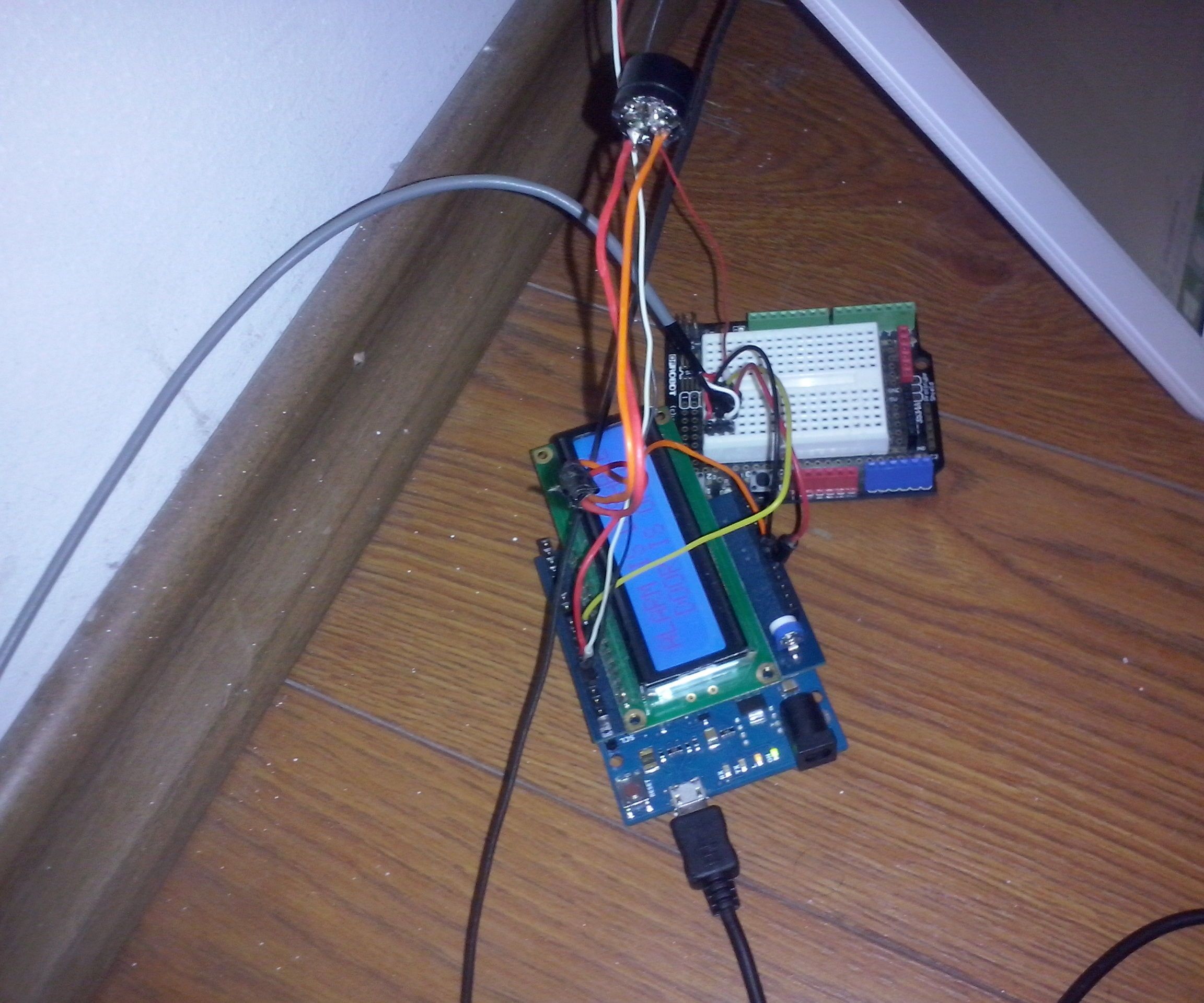

I conected to A5 using 2 4.7K resistors.

For Connected wires to Arduino I used a Prototyping Shiel.
