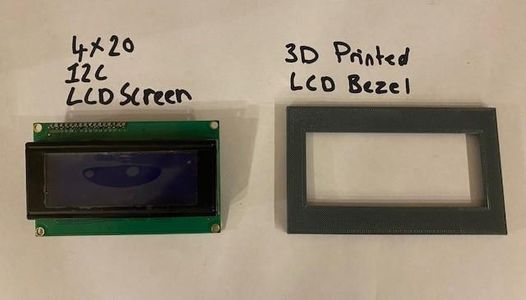

Step 2: LCD Bezel
I've included this section because this is another area of the project designed to be re-used with other projects. The bezel really tidies up projects that use LCD screens. I designed it using Fusion360 then 3D printed it using my Ender 3.
The bezel is attached to the enclosure using strong double sided tape.
I have included the STL file for anyone who wants to 3D print their own LCD bezel.
