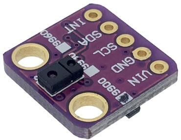

  • Gesture Color Proximity APDS9960 I2C sensor

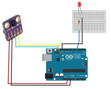

Step 3: The Circuit
  • Connect Sensor Pin [GND] to Arduino board pin [GND]
  • Connect Sensor Pin [Vin] to Arduino board pin [3.3V]
  • Connect Sensor Pin [SDA] to Arduino board pin [SDA]
  • Connect Sensor Pin [SCL] to Arduino board pin [SCL]
  • Connect Arduino board pin [GND] to LED negative pin [-]
  • Connect Arduino board digital pin [5] to 1k ohm resistor
  • Connect 1k ohm resistor second pin to LED positive pin [+]

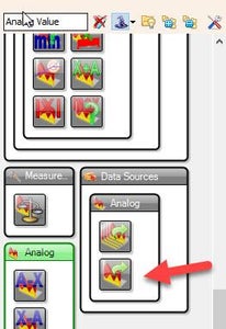

  • Add "APDS9960" component
  • Add "Clock Multi Source" component
  • Add "Up/Down Counter" component
  • Add "Analog Value" component
  • Add "Integer To Analog" component
  • Add "Analog Multi-Source Merger" component

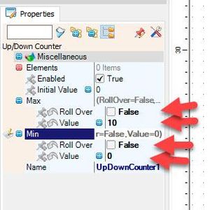

Select "UpDownCounter1" and in the properties window:
  • set "Max" > "Value" to 10
  • set "Max" > "Roll Over" to False
  • set "Min" > "Value" to 0
  • set "Min" > "Roll Over" to False
Select "IntegerToAnalog1" and in the properties window set "Scale" to 0.1

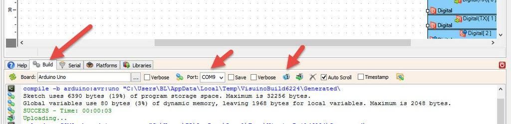

Step 7: Generate, Compile, and Upload the Arduino Code
In Visuino, at the bottom click on the "Build" Tab, make sure the correct port is selected, then click on the "Compile/Build and Upload" button.
