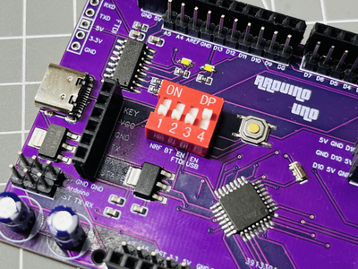

Step 2: Circuit Diagram:
The circuit of this microcontroller is quite simple, just follow the basics of data structure and datasheet. I am using CH340C as the USB to serial programmer. This chip has many variants and I am using “C” which has internal oscillator of 12MHz. Blue LEDs are used for Tx and Rx pins and Orange and yellow for the power and D13 pin.
1K resistors are used with these LEDs for current limiting. AMS1117 5volt regulator provide +5volt to the whole board. 100nF and 100uf capacitors for noise reduction and power filtering purpose. Tactile button with 10k resistor completes the reset circuit. A new generation USB type C for better looks and strong connection. I used Different pin headers for the I/O pins, Bluetooth connection and 12C.
The FTDI, Bluetooth, radio and USB can be enabled using DIP switch mounted in between of the PCB. Actually, this is the main component which control the action of whole circuit.

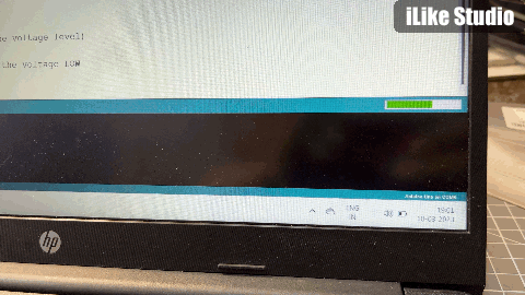

Step 7: Burning the Bootloader:
Before uploading any sketch to the Chip, you need to burn the boot settings to it. It can be done by simply using another Arduino UNO board. Upload the Arduino ISP code to the 2nd Arduino from the examples section.
Connect both the Arduino’s according to the given wire diagram. Then select the Programmers as ISP and click on burn bootloader. It will take a minute or less to burn the program successfully. After that you are able to upload any program to the chip. But I always recommend to go firstly with blink LED example.

Step 9: 1) FTDI Mode:
I added a FTDI features in this module, means if you want to program the any Arduino board like mini, Nano this can be directly connected to headers. No need of external programmer for that. Now you can switch between two modes of FTDI through DIP switch. 1St to program the onboard Arduino chip and 2nd to program any extremal MCU board.
Step 10: 2) Bluetooth:
I also added headers for the Bluetooth module. Offers to program the board wireless over Bluetooth. But we will cover that feature in another article. This module uses Serial protocol for the interfacing. And same DIP switch is used to ON/OFF the module.
Step 11: 3) NRF24L01 Radio:
Nrf24L01 is mostly used with Arduino as remote-control purpose. I added headers of NRF to one side of my Arduino board so that the module can be directly plugged in to the headers. All the connections of wires are labelled on the Arduino board PCB silk screen layer.
Step 12: 4) 3X3 I/O Header:
These are headers which is used to connect any digital sensor with 3 pins. Like DHT, microphone. No need to worry about the pin arrangement now. Because 3x3 headers form a total of 36 different probabilities to plug a module.
Step 13: 5) Direct 12C Features:
Some of the display module and sensor use I2C communication with Arduino. Now you can plug the 12c screen directly into the board with any sensor to get the value displayed on screen.
