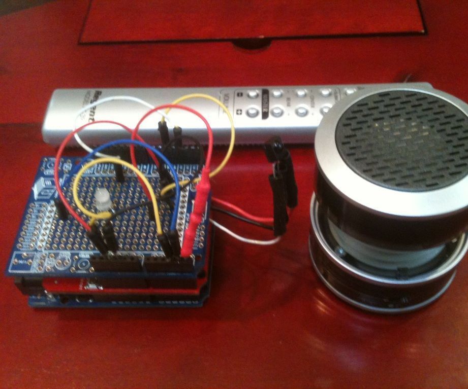

Introduction: Arduino Gloves (An Attempt)
So I did a project that was originally posted on instructables and tried to make it work. This is less of a tutorial and more of a 'this is what I tried to do and how it turned out.' Also for anyone who tried to do the same instructable as me, this has a couple of things I found out along the way.
the original instructable - https://www.instructables.com/id/How-to-build-an-Air-Guitar-with-Arduino-aka-the-A/
Step 1: The Stuff
The first thing I did was get all of the stuff I needed to complete it:
1. the arduino (arduino uno was what I was using)
2. an ultrasonic sensor,
used to detect the distance between your hands, which changes the pitch in the note ( http://www.mouser.com/ProductDetail/Parallax/28015/?qs=sGAEpiMZZMuVJC7Vq%252bMl53IruZP3FEtl )
3. an accelerometer, which detects movement for vibrato ( http://www.amazon.com/gp/product/B00CD2JIBK/ref=oh_details_o00_s00_i00?ie=UTF8&psc=1 )
4. conductive fabric for the gloves ( https://www.sparkfun.com/products/10056 )
5. 10K resistors, 1M potentiometers, a 10uf capacitor, lots of wire, a soldering iron and flux (especially if you solder like I do), all of this I found at Radio Shack
6. and of course a pair of gloves. I just used regular winter gloves.

Step 2: The Schematic / the Code
This is the schematic and the code I used from the other instructable. The only difference I made was I wanted to use two gloves instead of a glove and stick. That way if you wanted to mime any other instrument you could, for instance if I wanted to play it like a harp or something. That decision was purely visual-based.

Step 5: The Work / the Fail
These are mostly just pictures of getting everything together and all the soldering work.
The story of how this project ended is not a happy one. I had everything soldered the first time, but all of my connections were finicky. Since I've never done a project like this, I had my dad take a look at it the second time to double check things. Well, when all of the soldering work was done and everything was for sure going to stay, we turned on the arduino…and nothing happened. So we unplugged it and took it all apart. We left the arduino on (to see if that's where the problem was, and it came on so it was fine) and began plugging things back in. Any time we plugged the ground in, it would short itself out. Well after taking everything apart the third time, we discovered that the accelerometer was the culprit. I'd burned it. Checking everything else, we found out that was literally the only problem. Thus the fail, one chip that wasn't working...
