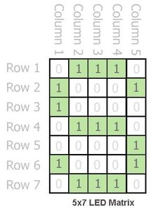

The purpose of this code is to split any text input into individual characters and then split those characters down into columns. Each column is then displayed on a single-column LED matrix, with short pauses between each column.
For example, when displaying the letter "S" on a 5x7 LED matrix, the state of the LEDs in each column (top to bottom) can be described using binary display.
Column1: Row1: LOW Row2HIGH Row3HIGH Row4: LOW Row5: LOW Row6HIGH Row7: LOW
Column1: LOW - HIGH - HIGH - LOW - LOW - HIGH -LOW
Column1: 0 1 1 0 0 1
And for the rest of the columns it will be like this:
Column2: 1 0 0 1 0 0 1
Column3: 1 0 0 1 0 0 1
Column4: 1 0 0 1 0 0 1
Column5: 0 1 0 0 1 1 0

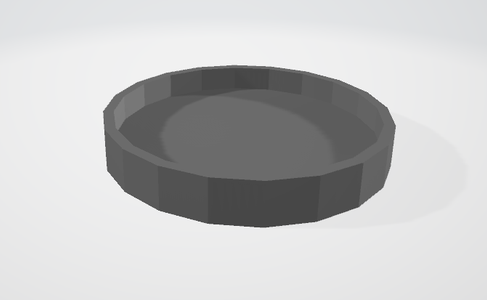

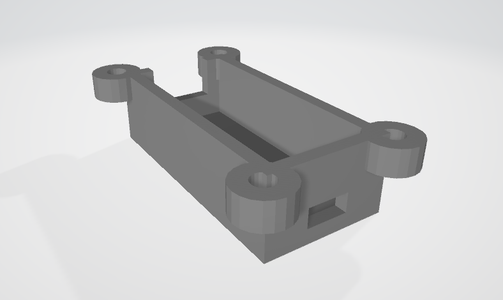

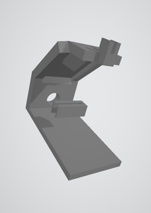

Step 6: 3D Printing
