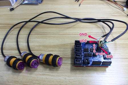

Firstly, put the Crowduino UNO on the table, then plug the Arduino sensor shield onto it. The sensor shield provides convenience to use sensors, and we can plug the three adjustable Infrared sensor switchs onto it easily as pictures show (use D5,D6,D7 port to connect). It seems like three tentacless with three eyes.

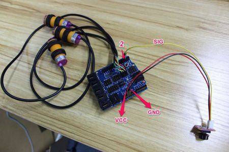

Step 3: Reset Button
Then we should set a reset button for every count. Crowtail- button looks more professional, the 3 pin crowtail to male splittable jumper wire also make it perfect for using with sensor shield. You just need to connect the GND, VCC, SIG to corresponding D2 port as follows:

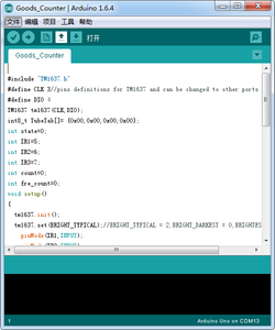

But we need to program it first, below is the program files, you can downlod and unzip it, please remeber to put the file named "DigitalTube" into the library, then upload the program to your Crowduino- UNO, it will make our application has a function: if something blocking any one of the three infared sensor switchs, it will do a count.

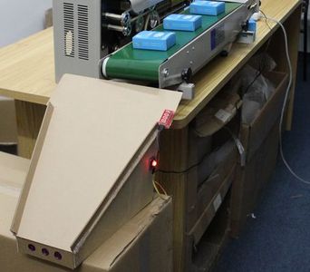

Step 5: Bulid a Home for Him
So how to use it to count goods? We can not always hold it for counting, it's time to made a home for "him" too.
Look at this big guy! It made of pieces of boards, there is a gentle slope that goods can through the Infrared sensor switchs one by one. Don't worry! It‘s assemble simply, just make the pieces of wood board glued together. Ok, well done! Let him live in his new home now. First, plug the three Infrared sensor switchs into these holes, then fixed the reset button and display on the board with glue.
It can work now as video shows, our colleagues seem very satisfied with it. The high sensitivity absolutely meet the requirement of counting. Be not underestimate this "boy", it will save much time of our work even reduce the error count.
