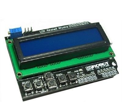

The project I built I used an Arduino Uno, Piezo buzzer, HC-SR04 Ultrasonic unit, KMR 1.8 TFT display.
The only part that may prove a little difficult to get would be the display, but there are alternatives, using an alternative display would mean altering the sketch to use the appropriate libraries for that display and possibly different pins. The display I used was purchased from This EBay seller an alternative one is here
all the other parts are easily obtainable. The ebay seller stated that the information for the display was available from their Dropbox site, that is not true and they have failed to send me simple usage instructions. Hopefully you will find this as enough information to use the display and in future the SD card connections if you wand to build a card reader and slide show unit :)
