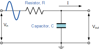

Step 6: Low Pass Filter
The low pass filter design used in this project is called a passive low pass filter. This is a simple series combination of a resistor and a capacitor, with the output voltage measured across the capacitor. A low pass filter has a cutoff frequency, which is the maximum frequency that will be passed through the filter. The filter we want to use has a cutoff frequency of 500 Hz, so that any frequencies higher than 500 Hz will be attenuated (their amplitudes will be decreased so that the Arduino doesn't pick them up).
To figure out the components to use in the low pass filter the following equation must be used:
fc = 1/(2*pi*r*c)
Where fc is the cutoff frequency, r is the resistor value needed, and c is the capacitor value needed. We will choose a stock value of .1uF (100nF) for the capacitor, and the cutoff frequency desired is 500Hz. Solving the equation above, the ideal resistor value needed is 3.18kOhm, but for the purposes of this build 3.3kOhm is within the acceptable margin of error.
