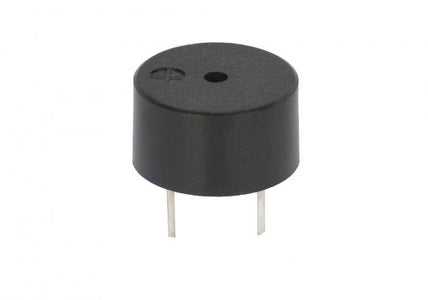

3. Buzzer

Buzzer
Vcc - Digital Pin 11
Gnd - Gnd
