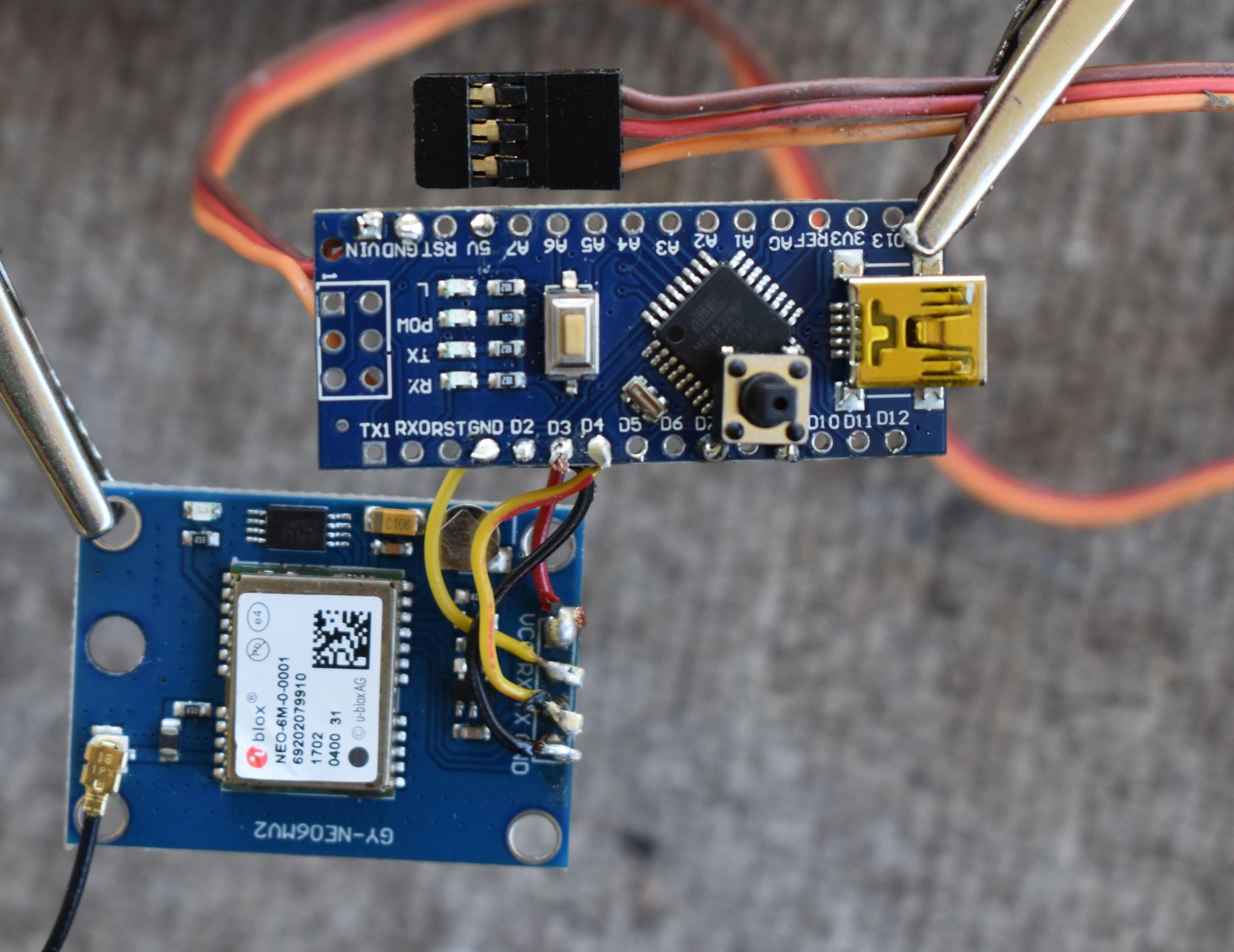

Step 1: Soldering the Arduino Nano
Firstly, we have to connect the screen to the Arduino nano. To do this I decided to directly solder some small gauge wire to the pins of the screen and used some heat shrink to ensure the pins or wires won't bend and touch together. The recommended pin connections are as follows:
  1. CS goes to A5
  2. RST goes to A4
  3. CD goes to A3
  4. LED goes to A0
  5. SDI goes to digital 11
  6. CLK goes to digital 13
  1. The NC pins have no control over the screen, they are only there to make it easier to attach to an Ardunio uno.
#Note:
You can change these pin attachments and adjust the code to suite the pins you used however these pins are recommended for faster screen refresh rates.
Secondly, we can solder the 'statistics' switch onto the Arduino. One of the outside pins of the switch can go to ground and the middle pin can go to any available digital pin, I opted for digital pin 5, remember to change this pin designation in the code if you attach it to a different pin.
Now, we can solder one of the on/off switches outside pins to the Vin pin of the Arduino. The middle pin of this switch can be connected to the positive side of a battery connection lead, here I used a female servo plug but an xt30 or xt60 connecter would be just as good.
Now, we can gather all of the 5V wires together, which includes:
  1. The screens 5V input
  2. The hall sensors 5V input (positive wire of a male servo lead)
and solder them to the 5V pin of the Arduino.
Then we can do the same for all of the ground connections except these go to the ground pin of the Arduino and include:
  1. The screens ground
  2. Hall sensors ground (negative wire of the male servo lead)
  3. Ground of the battery connection lead (negative wire of the batteries female servo lead)
Lastly, we can connect the hall sensor output wire (Signal wire of the servo lead) to the A2 pin of the Arduino. A digital pin should also be fine with a bit of tweaking in the code however I had some issues with my hall effect sensor not giving proper digital outputs, so I opted for an analogue connection instead.

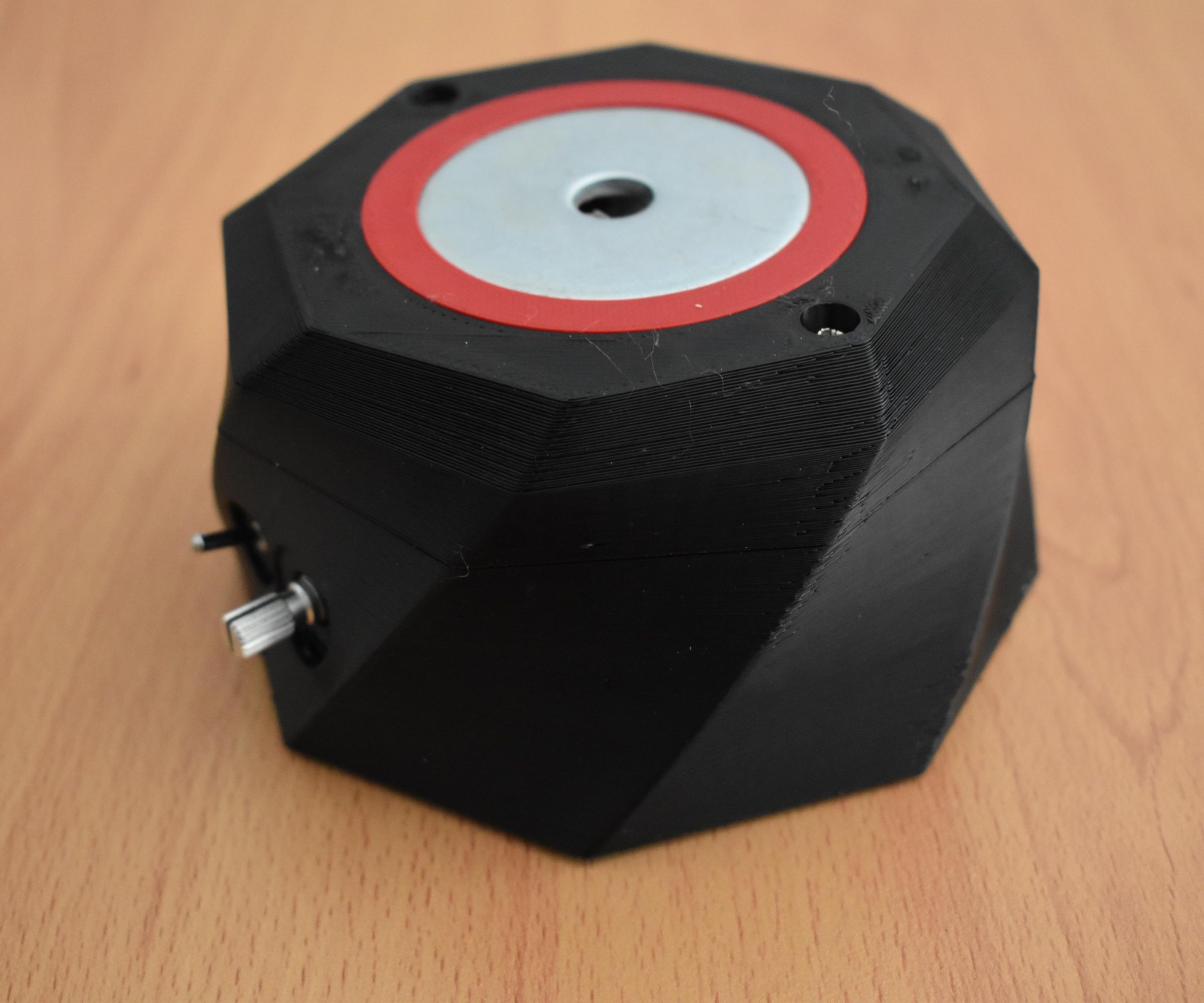

Step 3: Constructing the Case
I have attached all the 3mf files which I have made under each separate section, and they will all have to be 3d printed. I used a 0.4mm nozzle with 0.24mm layer height, and a 2-layer wall count. I printed all of the parts with Overture PLA.
Once printed we can start assembling all the components. To do this we start with the gasket part, light blue, and feed the Arduino through the rectangular hole such that the screen will sit nicely above it and the SD card holder fits within the open cutout. Then we can fit the switches into the rectangular holes on the side.
Now we can fit the topmost part over the screen and switches such that it holds everything down, after we do this, we can squeeze the Arduino into the cavity in the base of the component making sure to feed the battery and hall sensor connecters through the hole in the bottom. Then we can put the m3 x 30mm bolts through the 4 holes and tighten them down.
