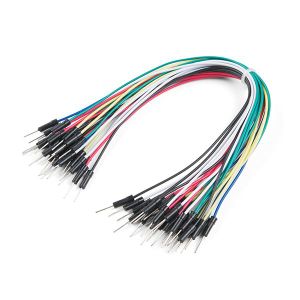

  • Jumper wires

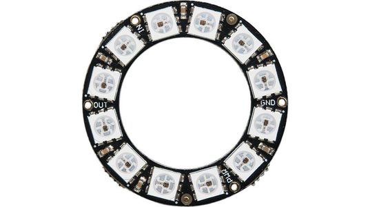

Step 2: The Circuit
  1. Connect LED Ring pin [VCC] to Arduino pin [+5V]
  2. Connect LED Ring pin [GND] to Arduino pin [GND]
  3. Connect LED Ring pin [IN] or (DI) to Arduino digital pin [6]

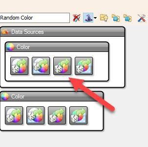

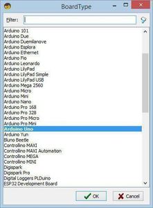

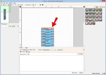

Step 3: Start Visuino, and Select the Arduino UNO Board Type
Start Visuino as shown in the first picture Click on the "Tools" button on the Arduino component (Picture 1) in Visuino When the dialog appears, select "Arduino UNO" as shown on Picture 2

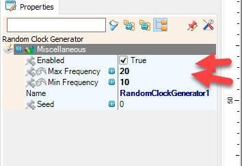

  • Select "RandomClockGenerator1" and in the properties window set "Max Frequency" to 20 and "Min Frequency" to 10

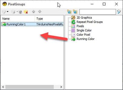

  • Double click on the "NeoPixels1" and in the "PixelGroups" window drag "Running Color" to the left
  • On the left side of the "PixelGroups" window then select "Running Color" and in the properties window set "Count Pixels" to 12 or 16 (Depends on how many LED your LED ring is having)
  • Close the "PixelGroups" window

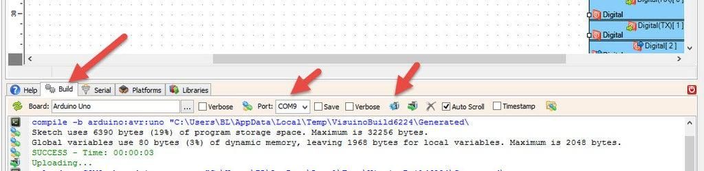

Step 7: Generate, Compile, and Upload the Arduino Code
In Visuino, at the bottom click on the "Build" Tab, make sure the correct port is selected, then click on the "Compile/Build and Upload" button.
