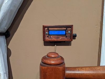

My daughter's bedroom is situated at the opposite end of the house from the HVAC system. Therefore, it can be a bit cold in the winter and hot during the summer months. To solve this problem, I used an Arduino to monitor the room temperature and turn on and off a space heater or window A/C unit depending on the season. This will require wiring 120vac to a solid state relay and then to AC outlet. Do not attempt this unless you have experience with house voltage and understand this can be very dangerous if done incorrectly.

There are 2 temperature sensors. One will just be mounted in the open air. The second will also be mounted up against the exterior wall. This is a brick wall that is 13 inches thick, but has no insulation.

This LCD display is very easy to setup and use. Arduino has a library that works well. Find it here: Arduino I2C LCD Reference. To use this library, open the Library Manager in the Arduino IDE and install it from there. They have some great examples. My display was capable of some extended characters. Included is a table showing them.
These LCDs are nice and bright. However, that is not always the best for use in a bedroom. On the back there is variable resistor that can dim the foreground (ie the characters). But the background light intensity is set to a fixed value by a jumper. Remove the jumper and connect a variable resistor and its now possible to change the background light intensity.

The SetPoint is the desired temperature in the prescribed living space. Often we speak about setting the temperature in our home. Strictly speaking one can't set the temperature, the temperature can only be measured. In HVAC system they talk of the SetPoint. This is the target temperature we want our heating/cooling system to achieve. If you have looked at my code, you see that the Arduino maintains 2 SetPoints, the heating SetPoint and the cooling SetPoint. Rarely, do we want those to be the same value, especially in a bedroom. The 360 degree Rotary encoder is an easy and intuitive user interface to raise and lower the desired SetPoint.
