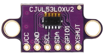

  • VL53L0X Time-of-Flight ranging sensor

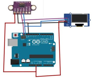

Step 2: The Circuit
  • Connect OLED Display pin (VCC) to Arduino pin (5V)
  • Connect OLED Display pin (SCL) to Arduino pin (SCL)
  • Connect OLED Display pin (SDA) to Arduino pin (SDA)
  • Connect VL53L0X sensor pin (GND) to Arduino pin (GND)
  • Connect VL53L0X sensor pin (VCC) to Arduino pin (5V)
  • Connect VL53L0X sensor pin (SCL) to Arduino pin (SCL)
  • Connect VL53L0X sensor pin (SDA) to Arduino pin (SDA)
  • Connect OLED Display pin (GND) to Arduino pin (GND)

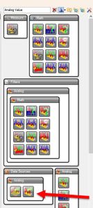

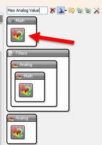

Step 4: In Visuino Add Components
  • Add "Clock Generator" component

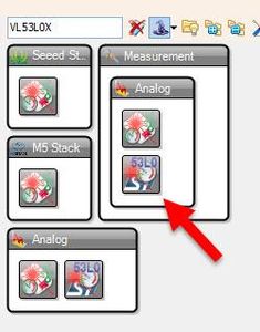

  • Add "VL53L0X" component
  • Add "Start" component

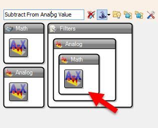

  • Add 2X "Max Analog Value" component
  • Add "Remember Analog Value" component
  • Add "Subtract From Analog Value" component

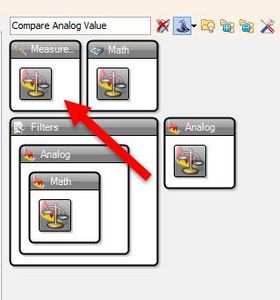

  • Add 2X "Compare Analog Value" component
  • Add "Analog On/Off Switch" component

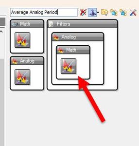

  • Add "Average Analog Period" component
  • Add "Analog Value" component
  • Add "Analog Multi-Source Merger" component
  • Add "OLED I2C" component

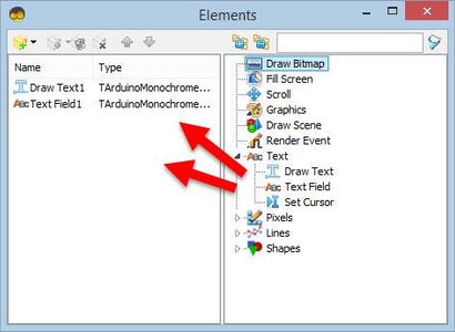

  • Double Click on the "DisplayOLED1" and in the "Elements" window:
    • drag "Draw Text" to the left side and in the properties window set "Size" to 2 and "Text" to HEIGHT
    • also drag "Text Field" to the left side and in the properties window set "Size" to 2 and "Y" to 40
  • Close the "Elements" window

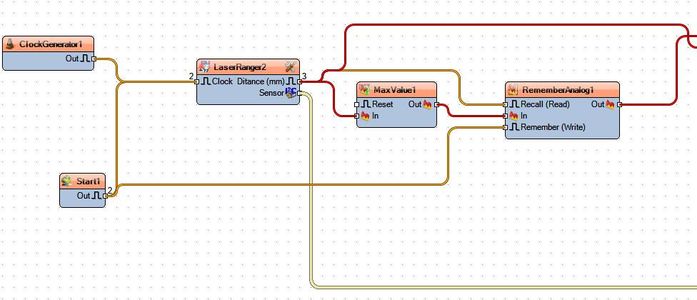

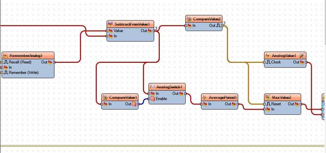

Step 6: In Visuino Connect Components
  1. Connect "Start1" pin [Out] to "LaserRanger1" pin [Clock]
  2. Connect "ClockGenerator1" Pin [Out] to "LaserRanger1" pin [Clock]
  3. Connect "Start1" pin [Out] to "RememberAnalog1" pin [Remember]
  4. Connect "LaserRanger1" pin [Distance] to "RememberAnalog1" pin [Recall]
  5. Connect "LaserRanger1" pin [Distance] to "SubtractFromValue1" pin [In]
  6. Connect "LaserRanger1" pin [Distance] to "MaxValue1" pin [In]
  7. Connect "MaxValue1" pin [Out] to "RememberAnalog1' pin [In]
  8. Connect "RememberAnalog1" pin [Out] to "SubtractFromValue1" pin [Value]
  9. Connect "SubtractFromValue1" pin [Out] to "CompareValue1" pin [In]
  10. Connect "SubtractFromValue1" pin [Out] to "AnalogSwitch1" pin [In]
  11. Connect "SubtractFromValue1" pin [Out] to "CompareValue2" pin [In]
  12. Connect "CompareValue1" pin [Out] to "AnalogSwitch1" pin [Enable]
  13. Connect "AnalogSwitch1" pin [Out] to "AveragePeriod1" pin [In]
  14. Connect "AveragePeriod1" pin [Out] to "MaxValue2" pin [In]
  15. Connect "CompareValue2" pin [Out] to "AnalogValue1" pin [Clock]
  16. Connect "CompareValue2" pin [Out] to "MaxValue2" pin [Reset]
  17. Connect "MaxValue2" pin [Out] to "AnalogMultiMerger1" pin [0]
  18. Connect "AnalogValue1" pin [Out] to "AnalogMultiMerger1" pin [1]
  19. Connect "AnalogMultiMerger1" pin [Out] to "DisplayOLED1" > "Text Field1" pin [In]
  20. Connect "LaserRanger1" I2C pin "Out" to Arduino Board pin I2C [In]
  21. Connect "DisplayOLED1" I2C pin "Out" to Arduino Board pin I2C [In]

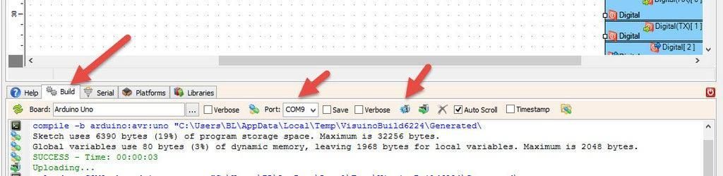

Step 7: Generate, Compile, and Upload the Arduino Code
In Visuino, at the bottom click on the "Build" Tab, make sure the correct port is selected, then click on the "Compile/Build and Upload" button.
