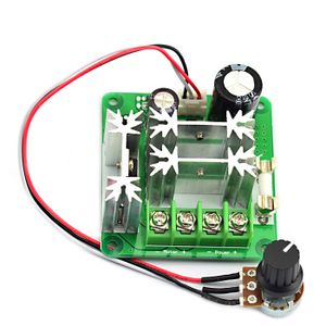

I needed to PWM (Pulse Width Modulation) a Highpower LED (60V): I needed tot dim the LED ;) And I did not want to solder a custom proprietary crap-ware piece hardware.

DX Jtron PWM DC Motor Speed Controller - Groen ( 15A / 6 ~ 90V )

Most of these circuits use the same layout, just spot for the 555 timer.
This works only when you manually want to control the pitch via the potentiometer. But that's not our goal. We want our internet of things to control our life, right? Our Arduino needs to control the Potentiometer. Again you can buy a 'digital potentiometer' chip for your Arduino. The problem is you need to solder again, which is not our goal :)
This circuit has everything we need. It can PWM up to 90 Volts @ 15A. More that you need, so that's a good thing. The 555 chip (timer) makes this board do it's PWM. When you strip it out, you can feed the Arduino's PWM into the board. Bob is you uncle!
Step 4: Get Dirty
Take a good shap, edge cutter made out of adamantium, and simply remove this piece of obsolete hardware. Now you have a naked module that's not working. But you did not break it, you kinda jailbroke a PCB
Now can feed the circuit with our own PWM that we control. Awesome!
Step 5: Removed 555
As you can see it's gone. You can see in a white diagram in the board. Representing a 555 chip. But the actual chip that we removed 'looks' different and is positioned different.
Also note the solder points. We need to figure out which one is the output. Looking @ the 555 layout, they don't correspond.
In the image I have made markers where to put the arduino Outputs.
If you hook up a PWM port (9|10|11) and the GROUND from the Arduino to these points. You can Dim the whole world. :)
