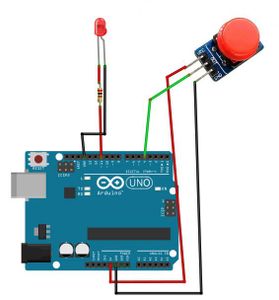

Step 2: The Circuit
  • Connect Button1 pin [VCC] to Arduino positive pin[5V]
  • Connect Button1 pin [GND] to Arduino negative pin[GND]
  • Connect Button1 signal pin [S] to Arduino digital pin[4]
  • Connect LED positive pin [+] to 200 ohm resistor
  • Connect other side of the 200 ohm resistor to Arduino digital pin[11]
  • Connect LED negative pin [ - ] to Arduino negative pin[GND]

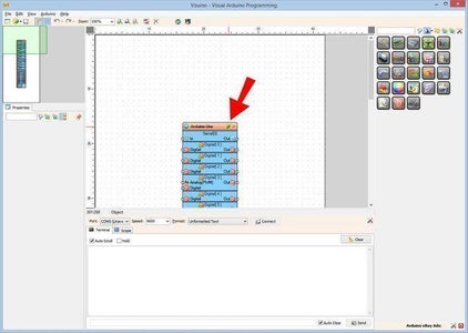

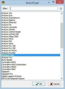

Start Visuino as shown in the first picture Click on the "Tools" button on the Arduino component (Picture 1) in Visuino When the dialog appears, select "Arduino UNO" as shown on Picture 2

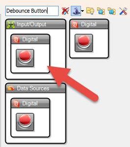

Step 4: In Visuino Add
  • Add "Clock generator" component
  • Add 2X "Counter" component
  • Add "Debounce Button" component
  • Add "Toggle(T) Flip-Flop" component
  • Add "Digital (Boolean) And" component

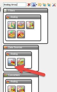

  • Add "Analog Array" component
  • Add "Analog Value" component
  • Add "Analog Multi-Source Merger" component

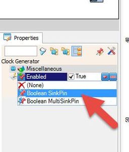

  • Select "ClockGenerator1" and in the properties window select "Enabled" and click on the pin icon and select "Boolean SinkPin"

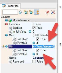

  • Select "Counter1" and in the properties window set Max > Value to 3 << this is the time for ON/OFF
  • and Min > Value to 0

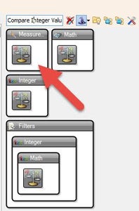

  • Select "CompareValue1" and in the properties window set "Compare Type" to ctBiggerOrEqual
  • and Value to 3 << this is the time for ON/OFF
  • Select "Counter2" and in the properties window set Max > Value to 5 << this is used for number of brightness steps
  • and Min > Value to 1

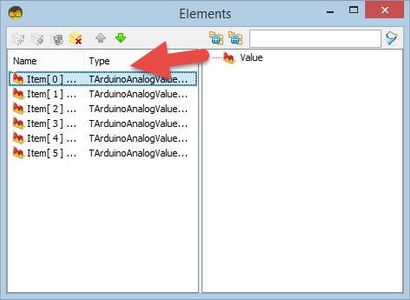

  • Double click on the "Array1" and in the 'Elements window"
  • drag 6x "Value" to the left side
  • For each value set the value in the properties window:
  • Value [0]: 0
  • Value [1]: 0.9
  • Value [2]: 0.7
  • Value [3]: 0.5
  • Value [4]: 0.3
  • Value [5]: 0.1
  • Close the "Elements Window"

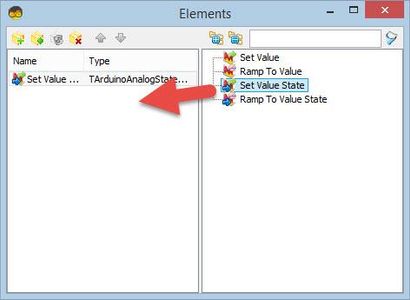

  • Double click on the "AnalogValue1" and in the "Elements Window" drag "Set Value State" to the left and in the properties window set Value to 1

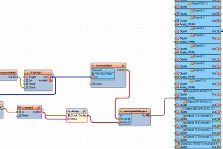

Step 6: In Visuino Connect Components
  • Connect Arduino Digital pin [4] to Counter1 pin [Reset] and ClockGenerator1 pin [Enabled] and Button1 pin [In]
  • Connect "ClockGenerator1" pin [Out] to "Counter1" pin [In]
  • Connect "Counter1" pin [Out] to "CompareValue1" pin [In]
  • Connect "CompareValue1" pin [Out] to "TFlipFlop1" pin [Clock]
  • Connect "TFlipFlop1" pin [Out] to "And1" pin[0] and "AnalogValue1 > Set Value State1" pin [In]
  • Connect "AnalogValue1" pin [Out] to "AnalogMultiMerger1" pin [0]
  • Connect "Button1" pin [Out] to "And1" pin[1]
  • Connect "And1" pin[Out] to "Counter2" pin [In]
  • Connect "Counter2" pin [Out] to "Array1" pin [Index] and pin[Clock]
  • Connect "Array1" pin [Out] to "AnalogMultiMerger1" pin [1]
  • Connect "AnalogMultiMerger1" pin [Out] to Arduino Analog(PWM) pin [11]

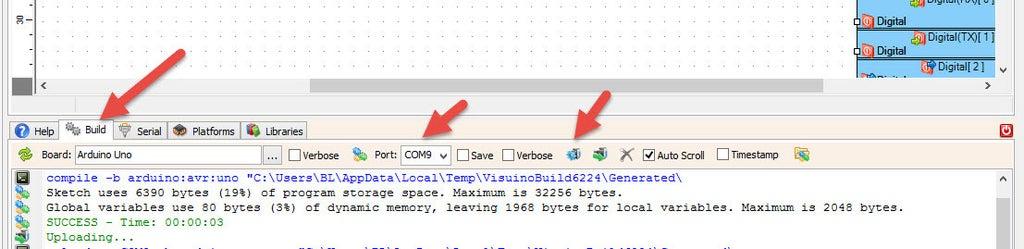

In Visuino, at the bottom click on the "Build" Tab, make sure the correct port is selected, then click on the "Compile/Build and Upload" button.
