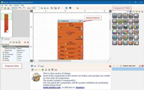

Start Visuino as shown in the first picture Click on the "Tools" button on the Arduino component (Picture 1) in Visuino When the dialog appears, select "Arduino UNO" as shown on Picture 2

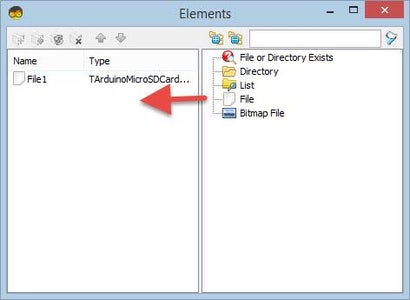

  • Double click on the "SDCard1" component and in the Elements window drag "File" to the left side
  • Now on the Left side of the Elements window select "File1" and in the properties window set "New Line" to False, "Path Name" to TEST.TXT

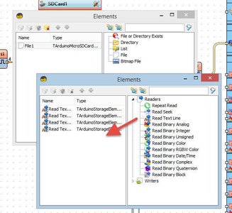

    and select "Elements" and click on the 3 dots button, a New Elements window will open, here drag 4X "Read Text Line" to the left side.
  • Close both "Elements" windows

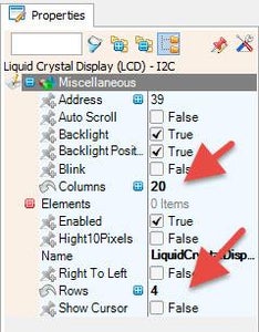

Select "LiquidCrystalDisplay1" and in the properties window set the properties of your LCD in our case the LCD is 20X4, so set "Columns" to 20 and "Rows" to 4
