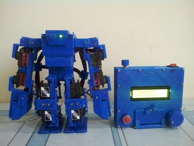

Introduction: Arduino Humanoid Robot -cancer Ms
Project: Cancer ms
Type: mini size humanoid robot
Height: 17cm
Weight: 450g+-
Dof: 16
Price: RM210 - 260 (USD50 - 65)
Components : , esp32 dev board(doit) x1=RM22.9, 7.4v 450mah 25c lipo x1=RM21.4,charger x1=RM16, jst plug(depends on battery) x1=RM1,mini 360 voltage regulator x4=RM26.5, micro switch x1=RM1(estimate), m2 v =RM10(estimate), petg filament=RM10(estimate) ,Total RM108. 8
Robot price without controller (estimate) :
Mg90s version : RM108.8 + RM102 = RM210.8 = USD 50.59
Sg92r version : RM108 + RM146.9 =RM255. 7 = USD 61.37
Controller : esp32, 1602a LCD, push button switch, KCD1-101 switch 21*15mm, potentiometer X 2, voltage regulator, llpo 7.4v battery or standard 9v battery.
Controller estimate price : RM 80 (USD 19.2)
