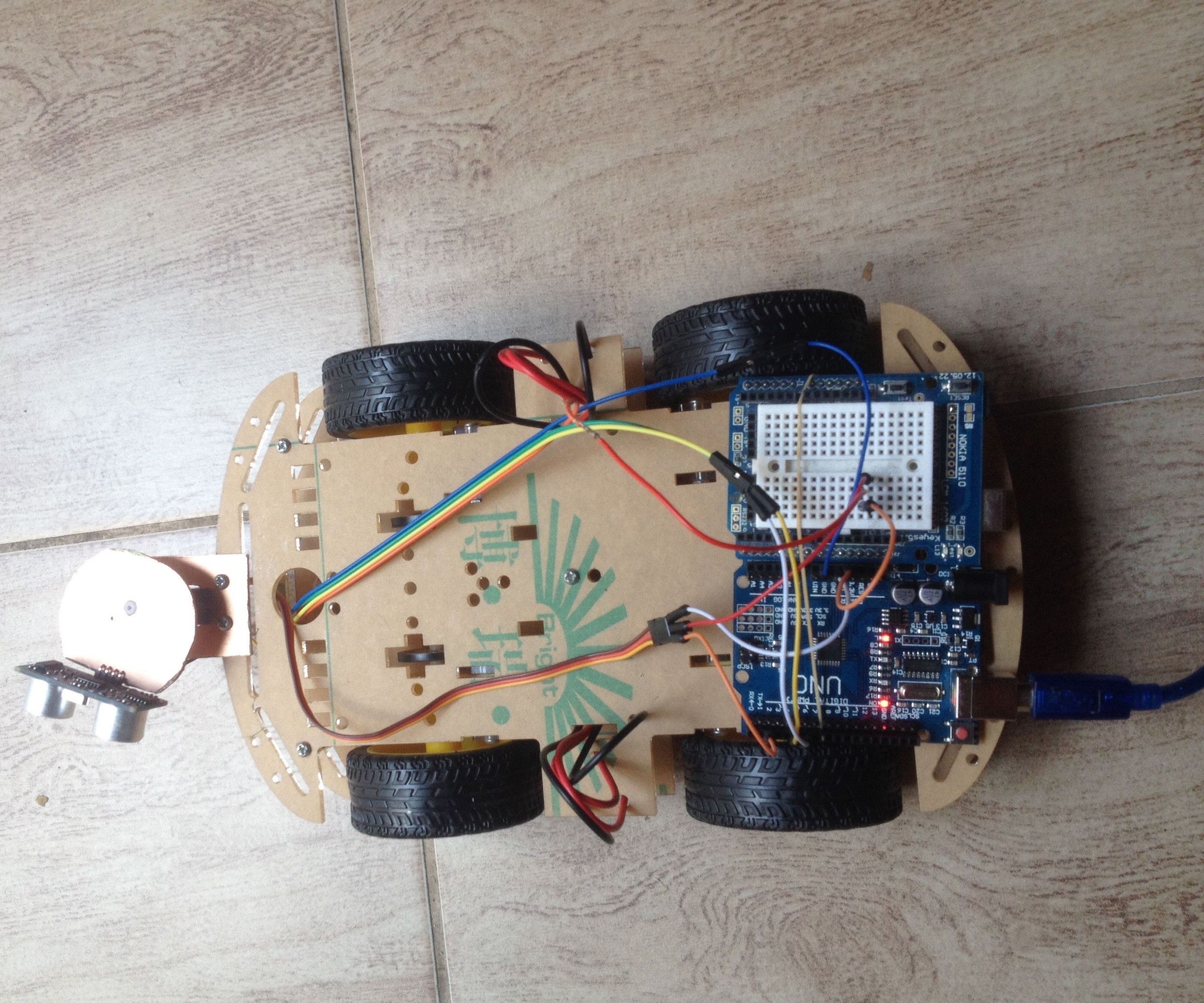

I am making a four wheel robot using two H-bridges which takes 12 digital ports and an uno only has 13, so i decided on using 2 arduinos, the sensors will be connected to the master and h-bridge to the slave.when the robot is comlete i will upload it here as well. I want it to work like a bobCAT :P, so i need to have individual control over all 4 wheels. please, leave all questions as comments and i will reply. Thank you.
